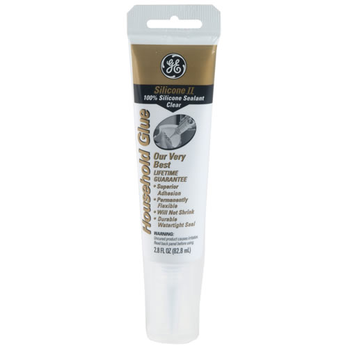

Although my topic seems to have been taken over, i could still use some help. I went out and bought some silicone sealant, but i dont know if it is correct because it doesnt say anything about pressure use...
Also, how do I apply it, how much should i use, and should i wipe off any excess sealant? How long does it take to cure?
The sealant i bought

That should work fine but details of the project would give us a better idea of what would work, for my iron cannon, which I over built and can an do take up to 500 psi only uses Teflon tape to seal the gaps.

That looks like the right stuff. It doesn't say anything about pressure on mine either. I just put a 1/4" thick layer on the first two or three threads of the male fitting, then screw it in as far as possible. Then I wipe off the excess silicone that gets globbed on the fitting. The cure time is usually 24 hours, and if you take less than that, it will spring leaks and you'll have to do it over again.
