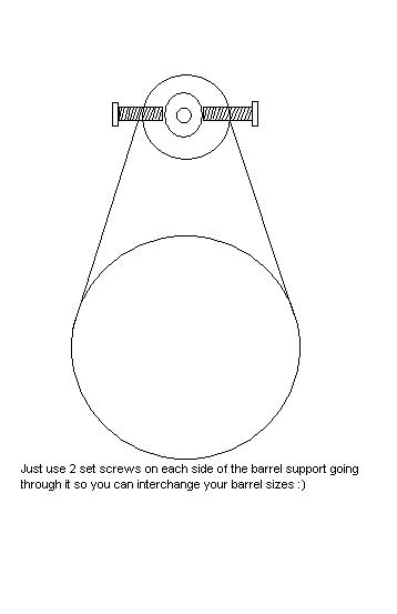

For interchangeable barrels you could drill out a bunch of endcaps or something, and adjust the ID of them to fit around different sized barrels. So then they could all fit into the same stock. If you had access to a lathe this would be really easy. Otherwise, it may take a little work to get them all drilled perfectly centered. To make changing barrels faster, you could use camlock fittings or modified air tool quick disconnects and just have the barrels slide in a piece of pipe or something, which could also be drilled and tapped for sights.spudthug wrote:hehe..the only thing about barrel supperts is its hard to have interchangeable barrels...

Adding a barrel support system so that the entire weight of the barrel isn't on that one fitting would be a good idea.
