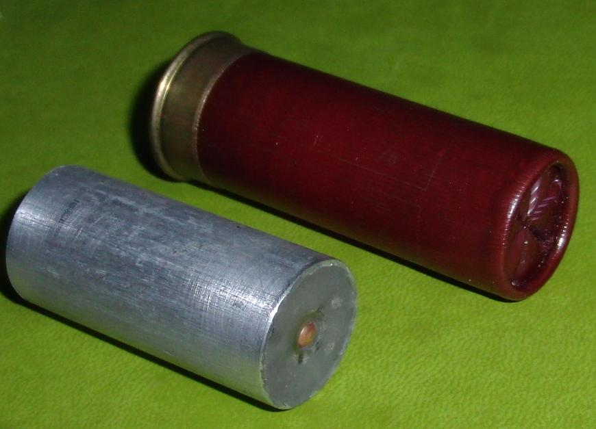

I have the prototype cartridge on my desk at the moment and I'm *really* tempted to try it out but the epoxy still hasn't hardened fully and I know better than to take my chances
edit: tested it for pressure retention, seems to be ok
here it is compared to a 12 bore shell, hybrid testing tomorrow.

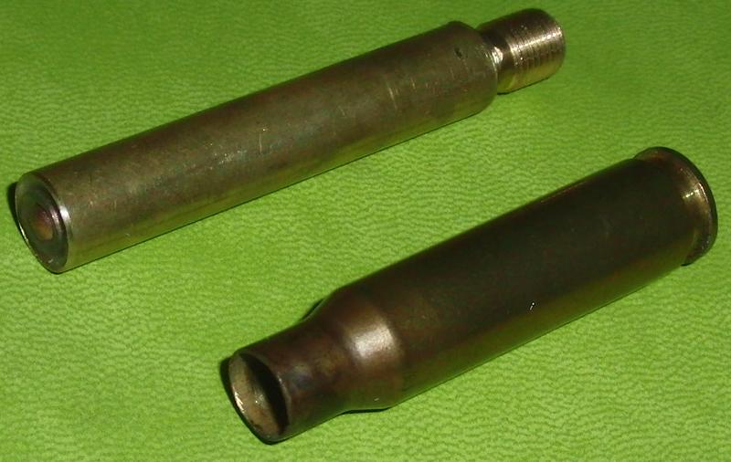

If only! The damn thing isn't holding pressure, gah this is so bloody frustrating!

I'm also surprised why no one didn't ask "It seems you have unfired 12 bore cartridges, what the hell are you playing about with hybrid cartridges for?"
that did cross my mind when i first saw the picture but i thought it wasn't that constructive to this thread but now you mention it, what the hell are you doing then?jackssmirkingrevenge wrote: I'm also surprised why no one didn't ask "It seems you have unfired 12 bore cartridges, what the hell are you playing about with hybrid cartridges for?"
... quite the contraryno one didn't ask "It seems you have unfired 12 bore cartridges, what the hell are you playing about with hybrid cartridges for?"
So that was the lighter/ball bearing check valve combo ?
Where was the leak from ?
I'm doing it because I can!ilovefire wrote:now you mention it, what the hell are you doing then?
Well, can't at this point
It's leaking from the check valve, for some reason. Didn't fire before. Or maybe it did fire without popping the projectile, and the heat from combustion screwed up the seal, fricked if I know.

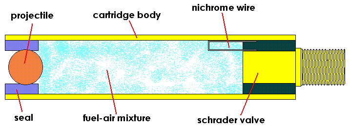

Perhaps another major rethink is in order. First of all, hot wire ignition as daccel had used seems to be a better idea than piezo ignition, if anything it should work at any mix number.
It might also be a good idea to go back to the "conventional" way of filling - injecting the fuel first through the mouth of the cartridge, sealing it with the projectile, then pumping air to the right pressure through a schrader valve. When I originally tried this, I couldn't get the right mix. The best logical reason I can think for this is that during pressurisation, fuel was flowing out of the cartridge and back into the pump head. Given the tiny cartridge volume, this would be sufficient to dilute the mix sufficiently to prevent ignition.
I plan to solve this issue by factoring the "dead volume" in, basically the space between the pump head and the pump check valve, when calculating the volume of fuel to inject.
This method should also allow me to reach much higher mixes than I can by manually compressing the mixture with a syringe, which is vital given the small size of cartridge I wish to work with.
- hycarthotwire.GIF (14.33 KiB) Viewed 3304 times

Why don't you just use a small premixed chamber to fuel it? That should be much more reliable and less frustrating.
You could just press the BB in and push the cartrige against the shrader on the premixed chamber.
Just use all brass fittings so there is no chance of a spark when you dissconnect the cartrige.
That's what I would have done atleast.

That will probably be my next move if this doesn't work
of course the premixed chamber still needs to be pressurised, but it can be much bigger than the cartridge so the dilution issue shouldn't be so pronounced.
Prototype curing, expect more tales of woe tomorrow
In the meantime, I calculated that the "dead volume" in my shock pump is about double the volume of my original cartridge, which assuming backflow of fuel into the pump would more than account for an insufficiently concentrated mixture.
