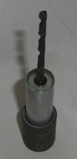

Here's what's curing at the moment:

This is how the current one is curing, I'm using a 4.5mm drill bit wiped with grease as a mandrel.
With enough lube, it would appear that anything is possible...

Got that epoxy cured up yet?
Cured beautifully
it pops very consistently at 50 psi, which means it's only good for 4x, which means it's useless, but yay o-rings!
The problem in this case is that although the o-ring has a 3mm I/D, since I cast it with a 4.5mm mandrel through it the ring is held open by the epoxy so it lowers the pop-off pressure considerably.

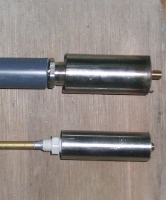

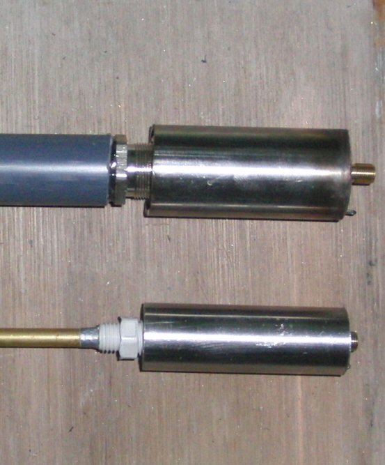

Following the success of this project, I've decided to ramp things up a little
still a "mini" by this forum's standards but with a 3/4" barrel and a wider chamber made of 2mm wall thickness 316 stainless, with the threaded fitting from an ATEX electrical connector.
As the weather's gotten colder it will be given a good baking today, testing later
here it is compared to the subject of this thread for scale:

Who knows, maybe by christmas you'll have a hybrid that's bigger than my hybrid's fueling meter
Kidding aside, I'm glag to see you've ramped things up a little. Bigger may not always be better, but it sure is more fun. Do you literally bake your epoxy creations by the way? Just wondering what your method was and if it's better than conventional methods of leaving it in the garage over night
Who knows, outback boyMrCrowley wrote:Who knows, maybe by christmas you'll have a hybrid that's bigger than my hybrid's fueling meter
Most epoxies cure faster when at higher temperatures, in Summer I can leave stuff out in the sun and it will be done in 12 hours whereas in Winter sometimes it doesn't cure after 24 hours. At this time of year I find chucking curing parts into one of the lab ovens at 50-60°C means that they're ready for testing by the time I get homeDo you literally bake your epoxy creations by the way? Just wondering what your method was and if it's better than conventional methods of leaving it in the garage over night
