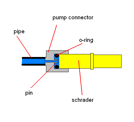

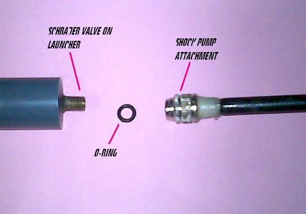

This may be a dumb question but how do you get your pump off with out letting the air vent behind the piston?
o-rinbg between the schrader ands the shock pump, which seals the connection butsn't allow the pin on the pump's female thread to physically open the swchrader's stem, meaning the schrader acts as a check valve and will be closed when the pump is removed.

you know jack i kind of get it but i diagram would solve my stupidity.

Simple really, find an o'ring that is the same diameter as the valve (6mm), place this in the part that screws onto the valve.

Oh come on, it's really simple - you just need to put an o-ring or similar rubber seal between the schrader and the pump connector, in such a way that the connector's pin cannot physically touch the schrader stem.
For those who still don't know what I'm talking about, it's this simple:
