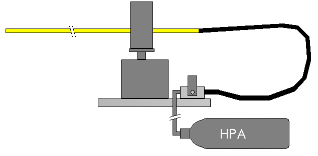

I've been thinking about this (because damnit, I have all the bits now, I just need to put them together!) in order to reduce the load on the servos and maybe have more reliable function, have a flexible tube between the valve and the barrel that would allow the trigger to be fixed to the base, and have the tube itself as the BB chamber, without the inconvenience of vortex blocks etc.

hmmn not a bad idea.. 6/4mm polyamid or polyurethane tubing would be ideal

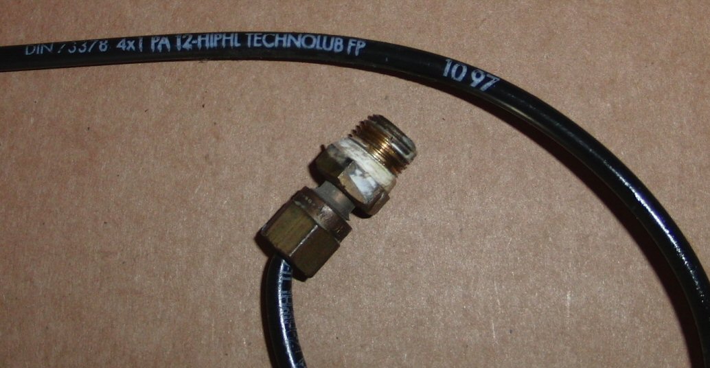

Coincidentally, I have this stuff (together with a convenient 1/8" compression fitting, I love my jobPOLAND_SPUD wrote:6/4mm polyamid or polyurethane tubing would be ideal
edit: feck... the little feckers still jam in the pipe.
For being such small projectiles, they really are a pain in the arse!
Haha, I was afraid of that when I saw the original idea. Oh well.
As the diameter of the tube is exactly twice that of the ammunition I had similar fears, but hope springs eternalInsomniac wrote:Haha, I was afraid of that when I saw the original idea.

uhmm AFAIK tubing also comes in 4X1.5mm size... though I don't know if that will help
EDIT
no I checked that link that's 4X2.5mm... but I could swear I've seen one with ID of 1.5mm
anyway that's exactly teh tubing I've been talking about... you can also get push-to-connect fitting for them (which can be quickly connected disconnected).. the one you have right now is
screw-to-connect fitting
EDIT
Why not build it so that the valve and air supply is on the base, with the block and hopper on the turret? I haven't bothered to read back though the topic yet so I'm not sure if your design could work that way, but it seems workable.
That's what I meant by this:Insomniac wrote:Why not build it so that the valve and air supply is on the base, with the block and hopper on the turret?
Working on it as we speakI think I'll try remaking it with a vortex block constructed with a bit more care fed through the tubing
