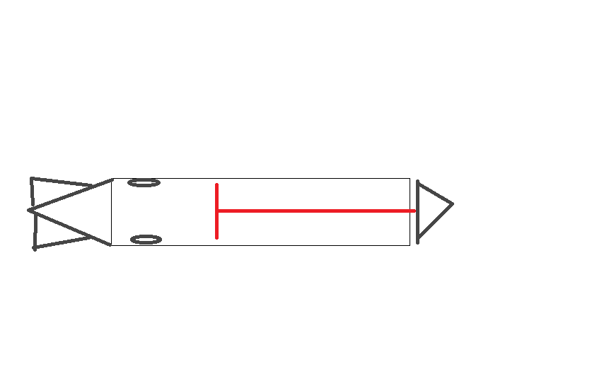

Sorry for the primitive drawing skills, but this may work Maudit. It could work as a marking round, that way you can see a little burst of flour or what ever you put inside it to see (glow powder would be pretty cool...)
- The grey nose pushes on the red rod which expels the marking powder out the rear holes. Might work, it should be worth a shot.

We did discuss something similar in another thread. I think the two main problems were:
a) not enough powder would be able to fit inside the projectile
b) the projectile may be buried too deep, too fast to expel enough powder to the surface.
Glow in the dark dye was, and still is, an option but the biggest limitation is having to shoot at night. Although no one would be on the beach at night, it's still risky in terms of visibility (goes against the cardinal rule of being able to see down range when shooting) and recovery as we may be using a quad (ATV) which can be incredibly dangerous.
I think one of the best chances of retrieving the projectile is calculating its Cd value. If that can be nailed to two decimal places (i.e., 0.08) then we could get a really good idea of the range. I will be shooting this at an angle of no more than 15 degrees for two reasons: I don't want to risk over-shooting the range and the projectile should fly straighter.
headlights on the ATV???? or an LED maglite duct taped to it.
That's one decimal place, and two sig figs.nailed to two decimal places (i.e., 0.0)

Could you drill holes in the side of the body and install little flashing recessed LED's with small batteries in the body? You could just have them flash or stay on. But then again your limiting it to night or near night conditions. That could be really bright at least.

No headlights, I guess a person could always hold a torch but the trouble is getting the ATV down to the beach from the house and back. It's only a few kilometers but some of that is on a state highway. Doing 40km with no headlights on a highway out in the country is pretty dodgy in NZ due to our narrow roads and 'hilly' terrain. It'd be fine during the day when cars can easily see us but I don't think I could convince my friend to drive at nightheadlights on the ATV???? or an LED maglite duct taped to it.
The trouble with LEDs, like the smoke idea, is that they would only give me a general direction the projectile is travelling. I think with good wind conditions, the projectile wont deviate much at a low angle, the hardest part will be finding where it lands.Could you drill holes in the side of the body and install little flashing recessed LED's with small batteries in the body? You could just have them flash or stay on. But then again your limiting it to night or near night conditions. That could be really bright at least.
That's why I think finding the drag of the projectile is important. If the possible impact zone is, say, 3500m ± 100m, theoretically we'd only have to search a 200m x 50m stretch of beach (which is a feat in itself).
