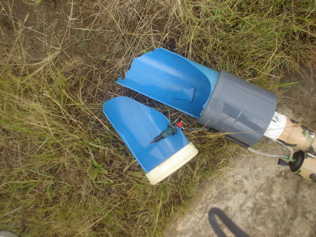

I figured it was the possition of my ignitor. It must have made a hairline crack in the pipe when i drilled the hole.

Wow that is some really really really thin pipe, thinner then DWV, you must of used down-pipe or spouting, not a good choice.

I think that cannon exploded because of how thin the pipe was more than anything. Even for combustions, you should use at least DWV SCH 40 pipe.

They told me it was pressure rated an 100psi. We use it on the farm for pumping water at high pressures
Sun Dec 09, 2007 4:31 pm
The blue stuff definitely does not look rated.

Well like i say we use the blue pipe to pump water From a dam at high pressures

Spitfire wrote:Well like i say we use the blue pipe to pump water From a dam at high pressures
Is the dam up hill or down hill to where you are pumping?

The ignitor definitely compromised the structural integrity of the pipe, but I agree with the opinion that it looks too thin to support pressure.

Uphill about 200feet higher than the dam. Irrigation in appel orchids
Mon Dec 10, 2007 2:36 am
What's the pipe made of? Does it have any writing on it?

jackssmirkingrevenge wrote:The ignitor definitely compromised the structural integrity of the pipe, but I agree with the opinion that it looks too thin to support pressure.
I agree, you can tell where the crack started from the pic.
