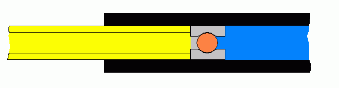

2mm tubing as a magazine didn't work for the 1mm BBMG, as my recent mishap illustrated the BBs flow out well enough without the barrel at the end of the tubing, but once I put that in they jam.
On a side note, I dug around my HPLC spares drawer, found what looks like 0.75mm I/D silicon tubing :D looks like I'll be fitting a detent after all hehe
yeah I can understand that.. I've just realized that one of the fittings I used to build the detent has ID equal to 2 X times the bbs OD.. so it is not surprising that it causes jams... I wonder if it will improve feeding by a lot :?
I think that you should use tubing that's 1.5 X times the OD of the BBs... that is 1.5mm in your case
True, having the BBs pass through tubing that is exactly double their O/D is asking for trouble. Sadly I only have 2mm polyamide tubing available.
Still, when I get home I'll do some single shot testing with a longer barrel and the silicon detent to see what the power potential is with the setup illustrated below. Who knows, the pressure buildup might cause a big enough flow of air to shock it into working reliably :roll:

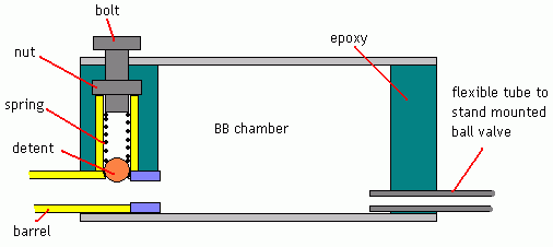

Not a huge step up but significant enough, I'm thinking 3mm calibre with a sealed adjustable detent to maximise pop-off pressure and reduce rate of fire in order to limit it to a short burst (5-10 rounds) per trigger "engagement".
3mm ? naah... go for 6mm (or at least 4.5mm...)
let's face it - at one point it will shot someone or something accidentally so make sure you can use some 0.12 or 0.2 airsoft rounds as ammo
Also with this calibre it's easier to build a gun (remember kubaT1000's gun ?). What is more if you get bored with it you can sell it to some local airsoft enthusists for a good price
....not to mention that technically it would be an airsoft turret so if you get caught with it you can say 'it's just an airsoft turret'
I want a projectile that can be easily missed in case it strays out of my shooting area, 1mm is perfect for this as it's practically dust, but it's too much of a compromise on power. With 3mm bearings the projectile is still pretty insignificant in terms of dimensions, but 27 times heavier that the 3mm so the jump in power is considerable.
I don't really want to go any higher than that though, I'm scared :shock:

It shouldn't be too hard to make, small cloud type chamber for 50-100 rounds, seal and ball detent.

I still think it's a better idea to build a proper 6mm version. something tells me you won't be satisfied with the performance of 3mm ammo
At least you would have a chance to test davidvaini's idea (hopup unit). Though if I were you I'd use a solenoid valve + timing relay as the firing mechanism, not a bv
In my experience 3mm + HPA = win ;)
I know I've already said it over 400 times or so but RC servos are not up to the job. I'd love to see even the simplest decent turret that uses geared down DC motors (or step motors) for controlling both axes. Then you can make it do just any kind of stuff you wish.
Again, if you're making a TRAP style sniper system firing accurate single shots, or an indirect fire artillery type turret that will hit a specific GPS coordinate, by all means this would be a better idea, but for this project it's a needless complication.
-_-, I had seen that elsewhere, and it's a very good analogy for the 1mm "sandblaster" :D
This is what I had in mind for the launcher, nothing too innovative or complicated:
