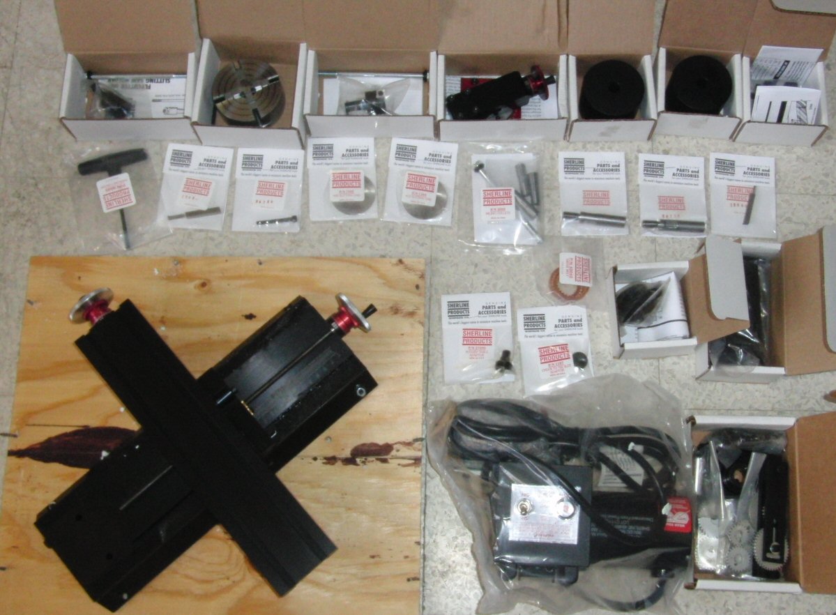

LeMaudit wrote:The easy alternative is to buy a miniature carbide cutter for o-rings. You'll find plenty of usages for it. Unless you really prefer to build tools and cutters instead of building cartridges.
I think tool building is a skill for later... What exactly should I be looking for? Something likethis?

What exactly should I be looking for? Something like this?
Yes. But be careful of the shank size when you buy, and check if you have the holder first :toothy10:
If you didn't bought anything else while I was not looking, you have a 1/4" square holder for the lathe. And 3/8" round for your mill (3/8" end mill holder and 3/8" max on the drill chuck).
You link show a 1/4" round shank. To my knowledge, Sherline only makes a 3/8" round Tool post for the lathe. I don't know why, though make a 3/8" to 1/4" bushing adapter is not a big deal.
So your only alternative for using a 1/4" round chuck would be to use it on the drill chuck + mill, with your piece to groove on the rotary table. You could have used colletsas a very good way to hold 1/4" chank, but for cost reasons they are not in your basic set :wink:
Or you can use another end mill holder size. Additional costs again.
As a rule, try to avoid cutting anything that will make a strong lateral force on the drill chuck, like with a end mill for example. Drill chucks are made to take a longitudinal force, not a lateral one. You will ruin your chuck precision if you do it. You can do it while you have not other accessories, but with very light cuts.

LeMaudit wrote:Yes. But be careful of the shank size when you buy, and check if you have the holder first :toothy10:
Lesson learned, thanks ;P
I think I should hide my credit card, work with what I have for a couple of weeks at least, then see what I really need and what I will probably forget in a drawer.
Send it to me. I'll use it when you need it :D
Very good! Make that a couple of month, and try to buy as much as possible in a single shot, you'll save a lot of shipping charges. Take the time to go through a whole machinist catalog, like KBCTools. You'll know what exist, what is cheap or not, what you can fit on your equipment and what additional tool holder you will need. And it's fun too :wink:
Sound advice. I predict that before the year is through I would have purchased a separate motor and table for the mill...
