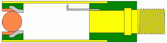

Hmmm... something like this? Maybe ribbed for extra pleasure, this could be done with a file spinning it in a drill...
inonickname
Posts: 2606
Yeah, that'll be fine. Use a small round file and don't make the grooves too large or the current will jump the gap rather than going across the surface. A sparkplug would be a good guide.
You could probably save some time by using clear PVC or silicon tube as an insulator.

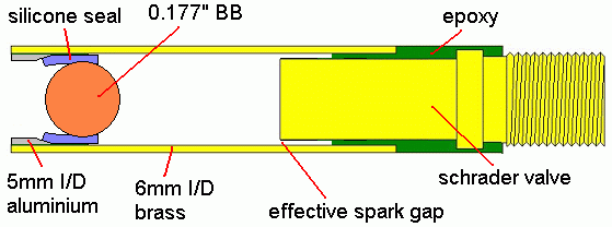

In practical terms I think what I'd make is something like this, it's simple enough to coat the schrader in Araldite as insulation - question is, will a relatively thin layer suffice?

JDP12 wrote:Wasn't there a thread awhile back about the conductivity of epoxy?
It was the hybrid cartridge thread, about the same issue :roll:
I've attempted to use epoxy alone as insulation in hybrid spark plugs, but the dielectric strength is insufficient to prevent arcing at even 3-4X mixes. A proper insulator is a must for reliable operation.
On the other hand, if you look atthe original subject of this thread and practically all my hybrid experiments, the only thing separating the schrader from the chamber is an epoxy plug... perhaps it's the thickness of the epoxy that does the trick?

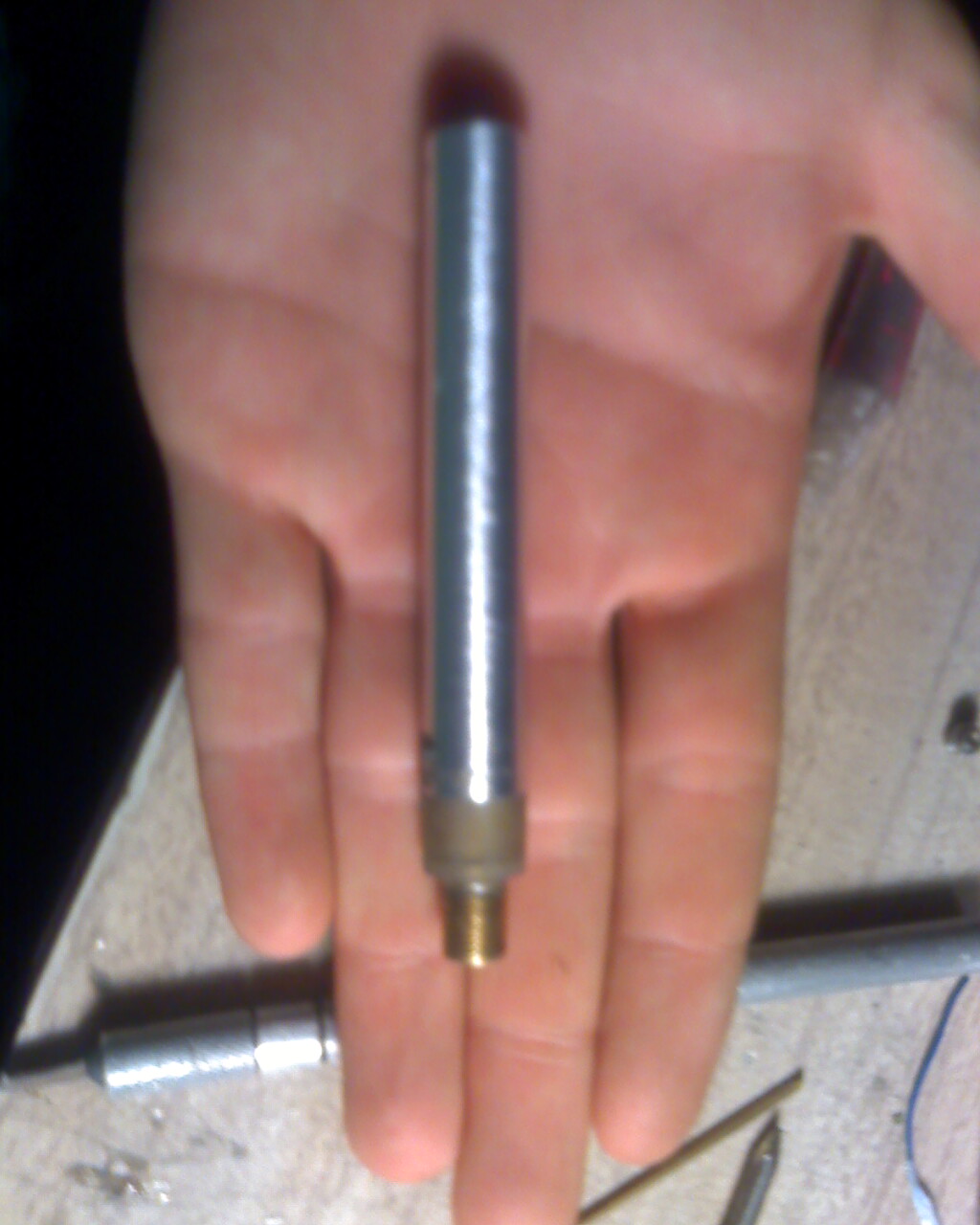

they i knocked this up a couple of days ago and thought you might be interested, its in 10mm ID aluminium (would have gone smaller but the burst disk holder wouldn't fit any smaller tube) whole thing is 9cm long and 1cm epoxy protrusion 4ml capacity and have tested it to 20x with an 8mm x 100cm barrel and has a little bit of a kick to it, downside is that iv made the spark gap to small for a piezo to work but its good with my 9v ignitor
sorry for the bad pic

Don't you mean the gap's too large for a piezo?
Either way, it looks nice and clean. Going in any particular project or just an experiment?

Insomniac wrote:Don't you mean the gap's too large for a piezo?
i think youll find that the smaller isnt always the better when it comes to the spark gap, i dont think the piezo has enough energy to ignite the mix with the spark gap as small as it is, it has only ignited with my high energy 9v powered ignitor (closest thing i can get to a taser in the AU, and it really gives you a jolt when you accidentally get yourself :lol: )
[/quote]Either way, it looks nice and clean. Going in any particular project or just an experiment?[/quote] :lol:
pretty much just an experiment, maybe if i get it to work with the piezo i might put it on a pistol grip and have it with interchangeable barrels, maybe even see if i can get it to pass 345ms with a long enough barrel and hear that satisfying crack :D
That's what I was thinking. Did you make it as per my last diagram above, if so any external arcing issues? Looks good, you should consider a blowback style shell ejecting action ;)
In my experience with a spark gap that's practically nothing (literally you can get a sheet of paper between the electrode and the chamber wall) the highest mix you can ignite with a cigarette lighter piezo reliably is 16x, it will occasionally ignite 17x but less than half the time.
well you would think it would be but when the gap is 1/10mm or less (just a guess but i would be surprised if it wasn't of similar size), well its stated above
[/quote]Did you make it as per my last diagram above, if so any external arcing issues? Looks good, you should consider a blowback style shell ejecting action ;)[/quote]
similar to the second last one but i have the wire the other way round, oh i would love to but im sure it will just get added to the pile of already unfinished projects i have spred all over my desk :roll:
edit: after i moded the spark gaps on my carts i could hardly see the spark, and i think this one is even smaller but i will have to do some more tests, maybe even go for a controlled 30x, so if i dont get back to you well.. :lol:

Perhaps your particular piezo is just too shizenhousen to get the job done?
