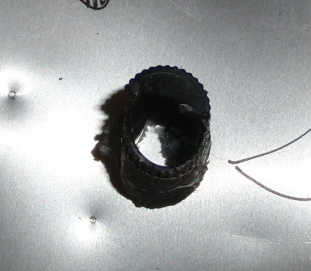

Tried a shotgun round using a plastic marker cap as a sabot, guess what happened :roll:
As you can see the sabot fragments made it to the target first, followed by the lead shot that was obvious not very energetic, having only the gas blast to push it along...
Here's what's left of the sabot:

ha ha ha what about making a cup out of layered aluminium foil, not sure if it would work but i think its worth a try

I would think that a plastic cup should be strong enough to survive the blast :roll:

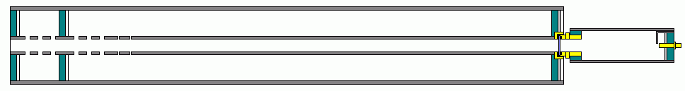

The hybrid R&D persists, I made a new chamber for a 0.75" barrel, this time just over three times volume of my previous one at 90mL. Tried it out at 6x and it was louder than the smaller one at 12x, which already exceeds tolerable noise levels for an urban environment, so I decided to make a suppressor to see what extent I can reduce the noise. It's a pretty basic design with 2 expansion chambers, but the suppressor tube is 100mm diameter drain pipe which gives it a total volume of over 5 litres :D currently curing, will probably test it tomorrow.

100mm diameter drain pipe... 5 liters
How long is the barrel again?
Properly designed, a five liter silencer should be good for anything up to and including a stealth hand-grenade. I know the other one you made didn't do much, but if this doesn't work you must be doing it wrong :P
Did you back the epoxy plugs with anything, to avoid fragmenting them when that pressure wave hits? They look pretty thin in the diagram.
Also, how do you intend to aim a .75" bore with a drainpipe in the way?

Fnord wrote:How long is the barrel again?
Around 75cm
The one I made for the mini wasn't exactly well made in the sense I was concerned about losing power so the porting was fairly limited. A "proper" suppressor would look something like this one ;)
Some very rough calculations for say a 5 litre suppressor + barrel and 100mL chamber generating 1000 psi, worst case scenario if you plug the muzzle it's not going to generate more than 20 psi, so I'm not too worried. Besides it's not just epoxy, I threw inthis filler, the result is incredibly tough and the plugs are over 1cm thick. The pipe wall thickness is only 1.5mm so it's not the plugs that are the weakest point anyway.
This is more of a test rig so aiming is not really a concern.
