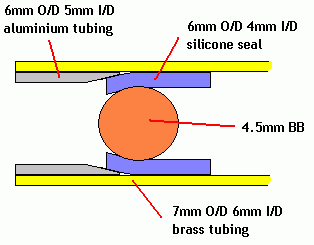

I'm still thinking of a smaller cartridge with a homemade check valve, perhaps with a crimped mouth to increase pop-off pressure with the same seal...
Alternative seal attachment increasing compression by forcing it a chamfered section of smaller diameter tubing

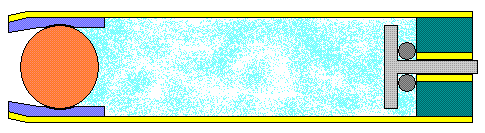

That check valve looks supsiciously like what I propose here.
jackssmirkingrevenge wrote:It has to work first ;) not to sound pessimistic but it doesn't look like it will.
How do you plan on filling this thing, locking it in a pressurised chamber? Will there be a spring between the fill valve and the piston?
Hey, you said it, not me :D :D
FWIW, I never got that thing to work. I don't think I lost it yet, though. :D
ramses wrote:That check valve looks supsiciously like what I propose here.
Which also looks suspiciously like my original hybrid cartridge idea that's been floating around the forums since the spudtech days :wink:
Since I didn't see any "win!" posts on the subject I imagined my pessimism was justified :)

Still working on this project, while the 3/8" cartridge works well it's still too big and low mix for my liking, so I've drilled out the mouth of this prototype and fitted this type of seal.
If it doesn't work I have another variation in mind, basically the same seal but inverted (with the seal "cone" opening outward) that would change the grip on the projectile and therefore pop-off pressure depending on how far you pushed it into the seal on loading.

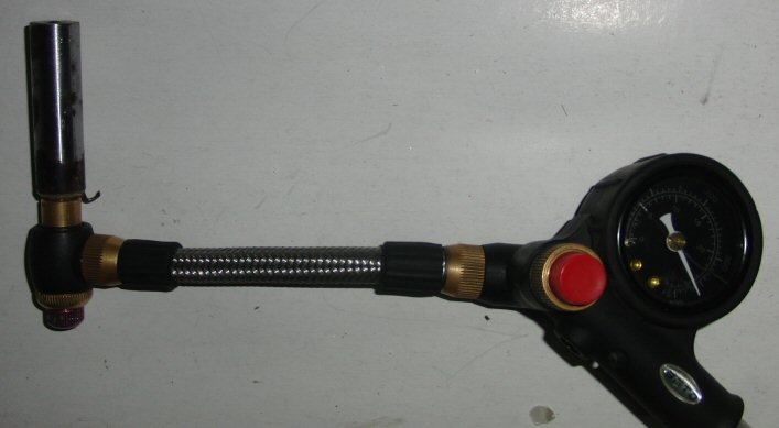

Update: The modified seal certainly held well, even hooked up to my paintball tank at 800 psi or so the BB didn't pop, though it stuck so much out that it looked like it was just about to, which sounds good for a 16x mix. For some reason though, the schrader filling valve failed on me so I was unable to try it as a hybrid. Still, inspired enough to make a new cartridge, keep watching this space :)
