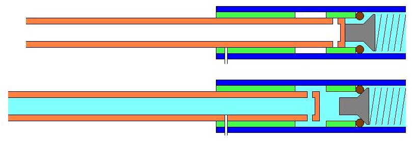

I have seen this gun before on the net. Wasnt sure how it worked though. Looks like a good project to make this. Do u know how the loading port for the bb's closes off? I chose for a moving barrel as it seals of the loading port before the valve is hit.SPG wrote:In many ways this is like the Gunpower Stealth range of airguns Airforce Talon in the US of A), except - they're single shot, and they don't move the whole barrel back to tirgger the hammer valve, just a sliding sleeve.
I like it though, it's very simple, but then the best ideas often are.
Some very detailed information about the mechanism here.ant wrote:I have seen this gun before on the net. Wasnt sure how it worked though. Looks like a good project to make this. Do u know how the loading port for the bb's closes off? I chose for a moving barrel as it seals of the loading port before the valve is hit.
This particular style of valve is extremely efficient, in fact the Condor model which uses it gets some of the highest power levels and air efficiency in its class.

I was looking at the internals and evrything and I just cant figure out exactly how it works... If i understand, when you press the trigger it realeses the barrel (the hammer) wich is pushed by that spring and hits the valve, this realeases air in the barell, But i cant understand how the barrel is pushed back into place.
And also, how exactly does the trigger work?
Thanks in advance
Thanks in advance
Plz check my new posted gif for the answer. Hopefully it makes it all clearer.nsane-spuds wrote:I was looking at the internals and evrything and I just cant figure out exactly how it works... If i understand, when you press the trigger it realeses the barrel (the hammer) wich is pushed by that spring and hits the valve, this realeases air in the barell, But i cant understand how the barrel is pushed back into place.
