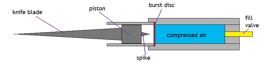

I've been thinking of adding a burst-disc in front of a sprinkler valve.jackssmirkingrevenge wrote:The thing is that if you're going to bother with the hassle of a burst disc, you might as well use it as your main valve and get much better performance than any piston valve could offer.
Probably won't be as good as a burst disc alone, due to the curved air movement inside the sprinkler valve. But should improve perfomance(?).
Also JSR, I've been thinking up a knife with a tube (barrel) as handle, and the knife has another tube, (like normal dagger only hollow handle),containing pressure.
And a burst disc at bottom. So either when it strikes something, the disc (inside bottom of handle) will rupture, fires the blade into whatever.
I want to design a trigger also that will press the burst disc to rupture it and shoot the blade through air also!!!
Got the idea off a spring powered military one that was banned but they still sold it without the spring.(can't find it now).

It should, but a simpler way of doing it would be to have a breech that is tighter than your barrel, avoids having to change disc every time while still delaying projectile motion enough for the valve to open fully.THUNDERLORD wrote:I've been thinking of adding a burst-disc in front of a sprinkler valve.
See attached diagram, I think I get your driftAlso JSR, I've been thinking up a knife with a tube (barrel) as handle, and the knife has another tube, (like normal dagger only hollow handle),containing pressure.
Personally I think that knives that fire their blade are a bit silly - the great thing about a knife is that it never runs out of ammunition, why would you want to throw it away?
The GRAD 22 revolver in that video makes a lot more sense. My personal favourite is the Russian (obviously
In the meantime, I'm casting a larger piston for the subject of this thread, hope to have some results by Sunday evening
- impactknife.gif (8.51 KiB) Viewed 2599 times

I've gotten off topic, but it's stuff I came up with replying here/ thinking of piston solution ideas. (strange how that works).
You got my idea, But how I was thinking, the burst disc would be on end where the shrader is shown and all parts in diagram one piece.
Then fitted inside another pipe for the external handle.
That way it could be retrieved and used as a knife. (maybe not good idea...)
Also there'd be a safety pin so it could be used as knife until whenever someone wanted to shoot it.
More of a novelty I guess (I had your same thoughts about the spring version).
