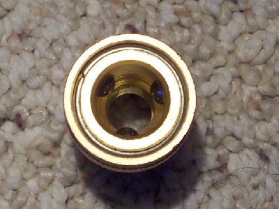

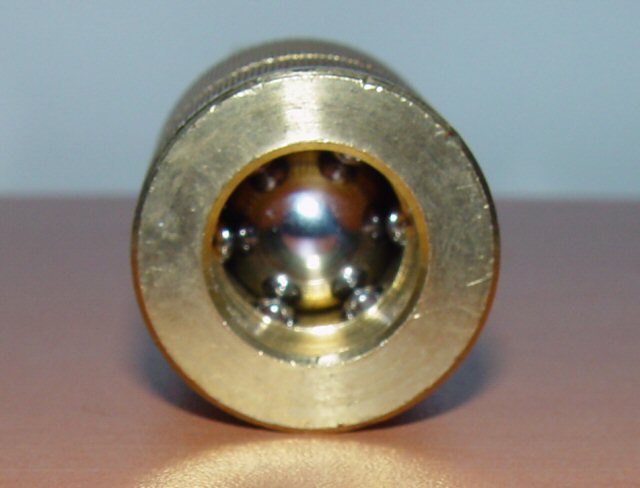

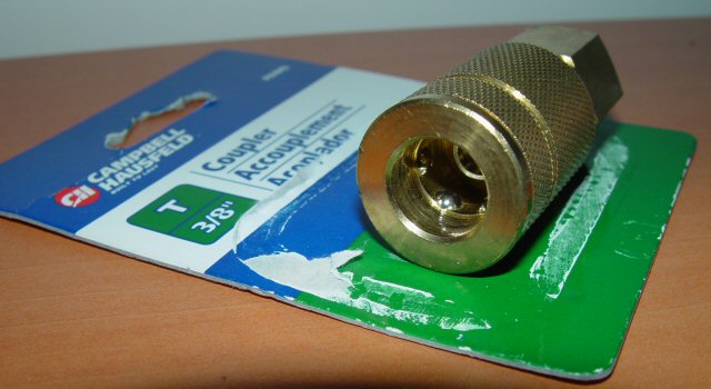

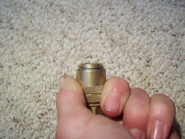

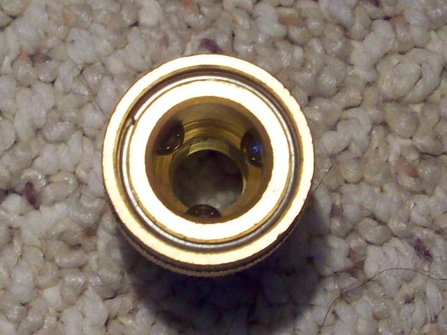

For those interest by the idea of using a quick coupling, I am most pleased to announce that a 3/8" coupling is a perfect fit for the .56 ammo I want to use...
So laziness will certainly win, and at some point in time I'll try to convert a coupling to a trigger instead of making one from scratch :-D
with a 9/16" = 0.56 ball bearing inside
brand new 3/8" quick connect

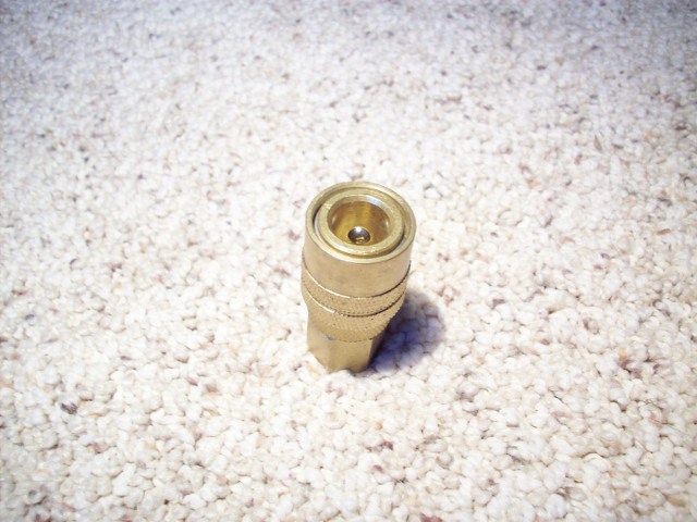

Edit: A disassembled male connector

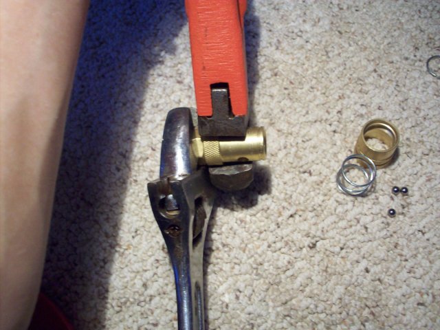

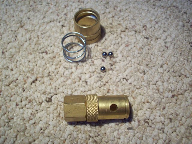

Useless post, but just in case you're wondering how to take one apart...
Assembly is reverse of disassembly.
Now, you can remove the check assembly.
Grip the main body as pictured to separate it. They are pretty tight...

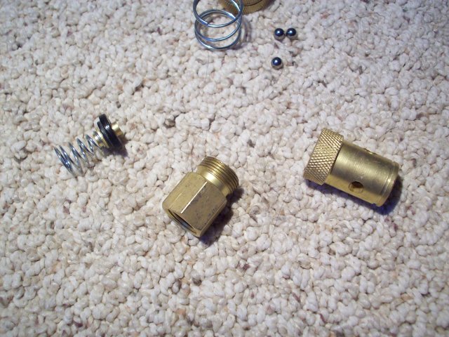

After this, you will be left with the components below.
There is a snap retaining ring which prevents the sleeve from being removed. Relieve the coupling of it with a flathead screwdriver.

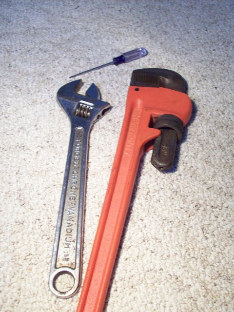

Tools you may need.
Tools you may need.
