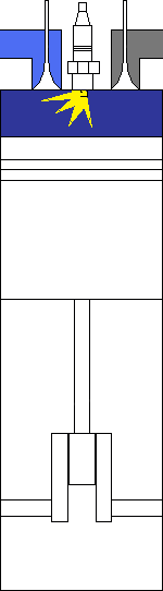

Well in that case screw it, I just made an animation. It took two hours with paint, Photoshop CS4 and Easy Gif Animator, But its done now. For any who don't know what the Miller Cycle is. Enjoy.
- The only change in the cycle from the otto cycle is the timing and duration of the Intake Cam. It stays open to decrease displacement
- Miller Cycle.gif (19.88 KiB) Viewed 4032 times
- Technician1002
- Posts: 5189
Nice animation. The pressure color gradient is a nice touch. The only thing I would add is an intake flow arrow and intake pressure indicator to show the lower vac on intake, the return of the gas to the manifold and accumulator, and the positive accumulator pressure on the next intake valve opening.rcman50166 wrote:Well in that case screw it, I just made an animation. It took two hours with paint, Photoshop CS4 and Easy Gif Animator, But its done now. For any who don't know what the Miller Cycle is. Enjoy.
Adding the carburetor, reed valve, and manifold volume (accumulator) to the drawing may help. A 2 cylinder version showing the manifold as an accumulator for the next cylinder may be helpful to show the transition from a 4 cylinder where the intake for one cylinder comes partly from another cylinder beginning the compression stroke.
I don't have Photoshop. Nice job. Keep me posted on your progress. I've never done an animation before.
The only difference I see between the Miller Cycle and the Atkinson Cycle is the addition of a blower so it is no longer naturaly aspired. The power to drive the blower seems counter productive to me from an effeciency standpoint as you again have high pressure cross a throttle plate.
The Miller is built for performance and the Atkinson is built for effeciency. You may wish to consider the effeciency of both designs.
