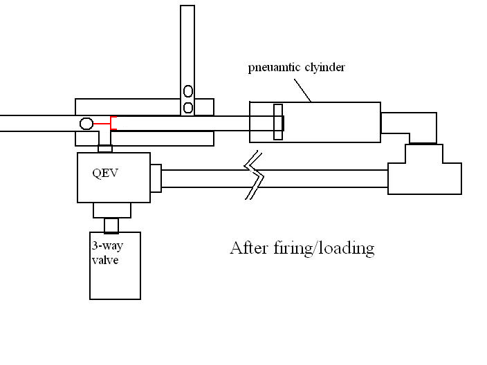

One thing I dont understand is: doesn't the qev fire the burst of air before that cylinder can activate the arm out?,because of where the QEV is I mean, I would have thought that the air would just fire out before that cylinder arm can push the BB forwards?.........
Nice job. How about changing the bolt head? The tube with holes drilled in it is kinda flow-restrictive and I recommend you switch to a pin.
The pin pushes the ammo past the QEV port, and the air can flow freely around the pin.
EDIT:
Attachment.
- improvement.png (33.39 KiB) Viewed 4954 times
I was considering a pin when a made it but I think if i start firing to rapidly the pin may get under the bbs and just push them back up into the mag instead of loading it forward. But your definetly right about the flow restriicition.
@django the cylinder actuates really quickly, Ive never had it fire berfore the cylinder has fully opened.
Patience is a virtue, get it if you can, seldom in a women, never in a man.
- POLAND_SPUD
- Posts: 5402
I don't think it can be a problem... I mean, it is not that you get this problem with a pin but not with a solid bolt...if I start firing to rapidly the pin may get under the bbs
in both cases it can happen... though it is very unlikely - the bolt would have to retract almost completely and then instantly advance forward

IIRC those small bore air cylinders are rated lower than standard ones... I've been thinking whether it is possible to strenghten them by threading them all the way into a coupler (the ones I've seen are all threaded on the outside so it might work)

Or add a switch that brakes the circuit when the air ram leaves the forward position. That also gives a synchronised system where the valve only fires when the bolt successfully moves forward.to achieve fully automatic fire you need either:
1. solenoid valve and time relay/555timer
2. time delay valve
- POLAND_SPUD
- Posts: 5402
you don't need anything... on the semiauto MKIII that port is as large as any other port...
the rod moves so fast that the ball can't fall and the rod in its forward most position prevents the ball from falling down
the ball falls in only if the air cylinder is not threaded in all the way in
yeah, it is that simple
