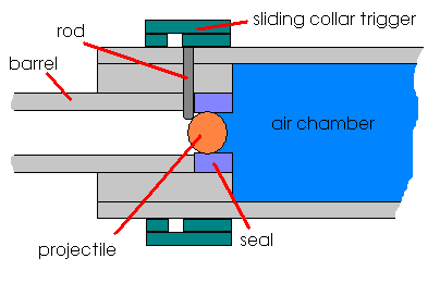

Since "valveless" is my word of the now, how about this for a super-efficient pengun

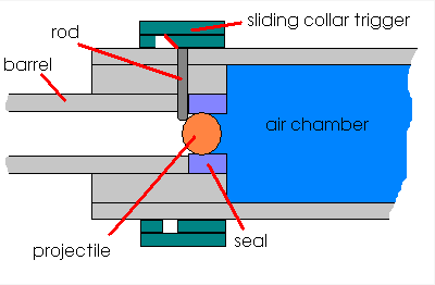

The pin restrictor would need an angle on it so it can reset the pin, like this:

Did you ever make a succcessful valveless gun JSR?

of course, that was just the concept drawingGun Freak wrote:The pin restrictor would need an angle on it so it can reset the pin, like this
Aside from my breech detent prototypes - where a valve feeds air into a chamber sticking the projectile in the breech until enough pressure builds up - I had made one design where the projectile is already held by the pressure and required to be physically released via the detent.clemsonguy1125 wrote:Did you ever make a succcessful valveless gun JSR?
LeMaudit had suggested something similar here, though I think I prefer to "roll my own"POLAND_SPUD wrote:not a bad idea... esspecially since you can use QC fittings to build it (ohh BTW there are smaller QC than those normally used for pneumatics... IDK what they are called but I think you can find them somewhere)
