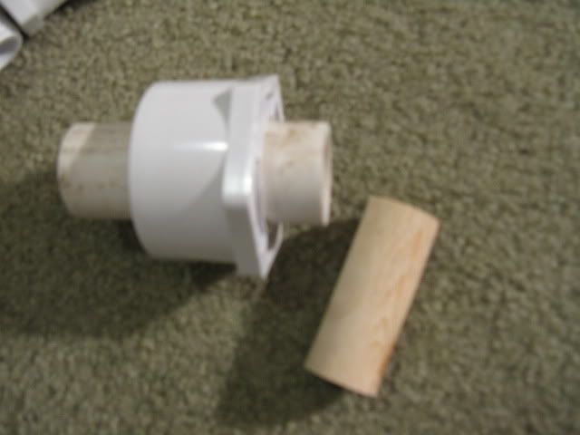

I worked on the cannon a bit more today and it led to another question. I have alot of pilot area in the 1" pipe. So I'm wondering if I can fill up this extra volume with a custom turned piece of wood with a small hole drilled through the center. It would essentially be shaped like a tube with very thick walls. Would it still be able to pilot if the hole through this piece of wood was only about 3/8"? This would make it much smaller than the piston which is ~1". Any ideas? I will have pics up later tonight.

That would work but is there any chance you could make it out of plastic stock instead of wood, that would last longer. Make sure the hole through the spacer is larger than that of your pilot valve and there shouldn't be any restriction.

That would work, but like Gun Freak said plastic might be better, if you have HDPE I think that would work great. Its what tech uses for his QDV pistons I think.

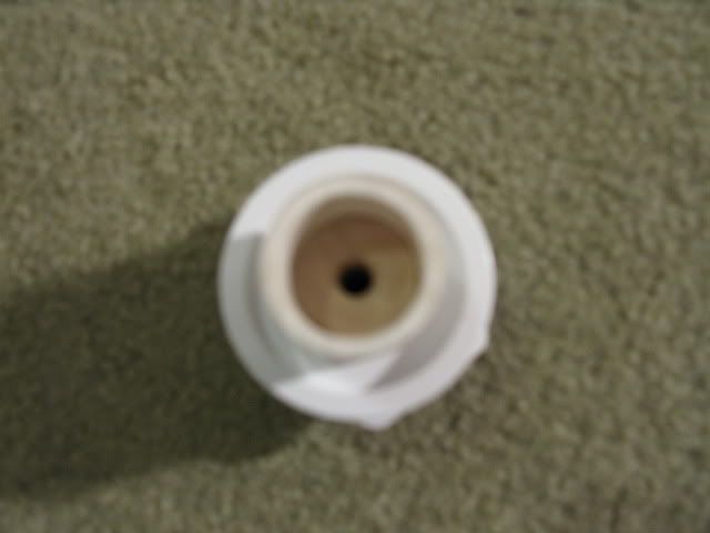

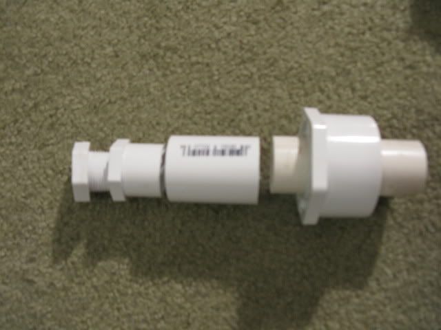

ok here it is so far. I'm going to drill and tap the back threaded plug so it will go to a modified blowgun that will be the pilot valve and the fill valve. You can see the round spacer which basically looks like a dowell with a hole drilled in the middle. The whole is currently 5/16 but can be drilled larger. and I have foam that will also go in the 1" pipe to cushion the piston, it will not just be slamming into the wood.

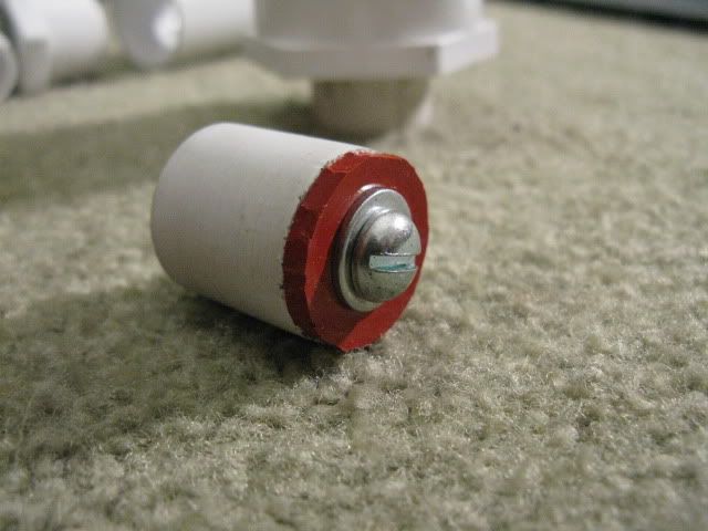

And just for kicks...my finished piston
So what do you think? Will this work alright with a modified blowgun? It just seems weird that the pilot volume is all going through this small tube.

That should work with a good bumper, It also looks like it would be easy to replace. If it were me I would fill it with rubber stoppers with a hole drilled through them, they would serve as a bumper.
