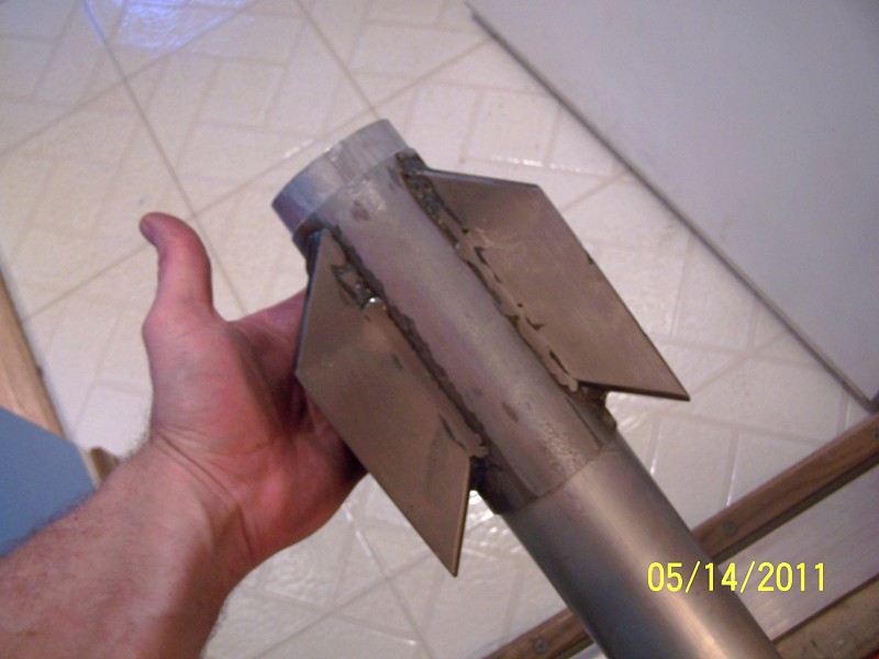

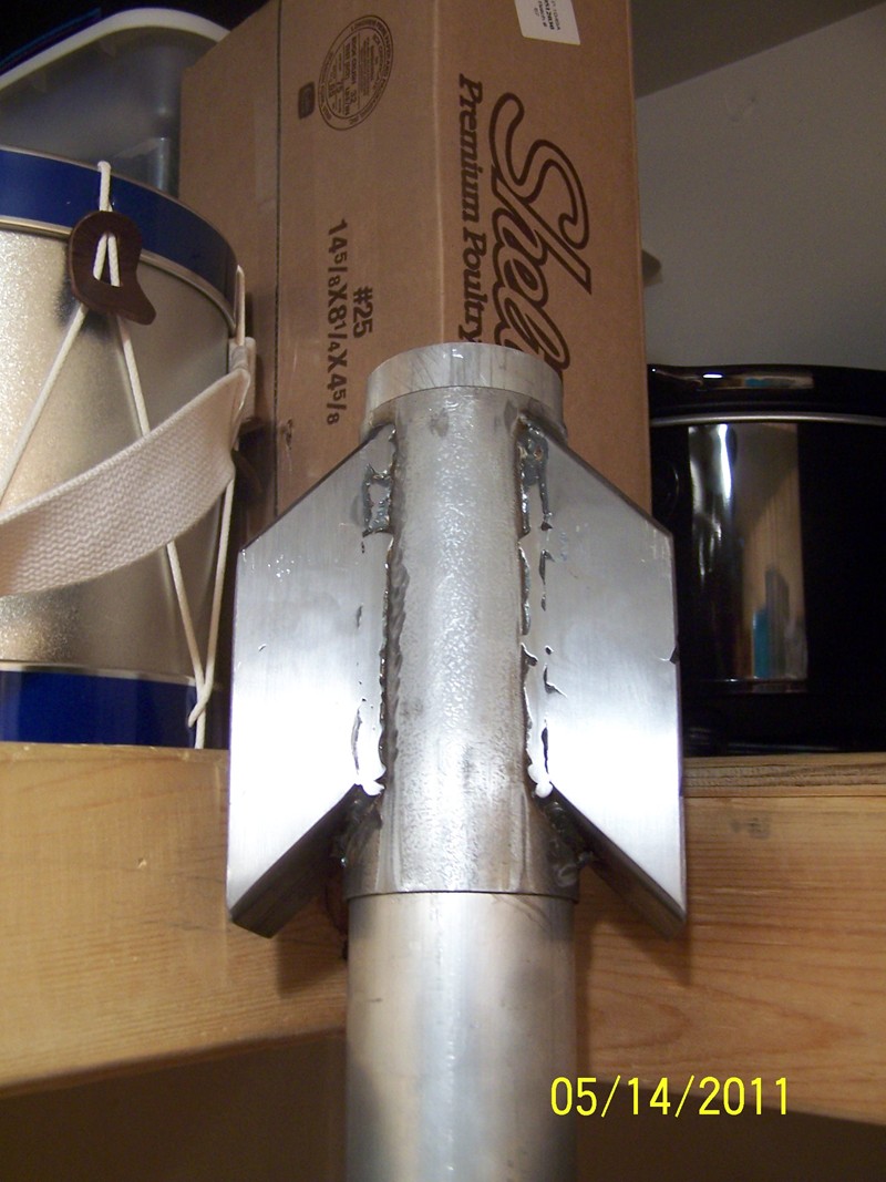

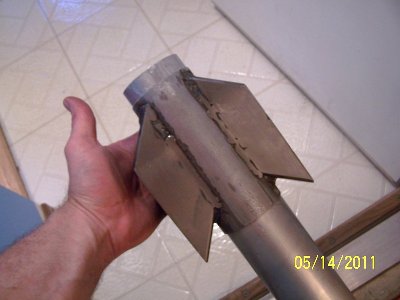

The reason I did not vent upward is, I do not mind the barrel rise. After all, this is not an automatic weapon. :)
I want to maximize recoil reduction, hence the double side vents.

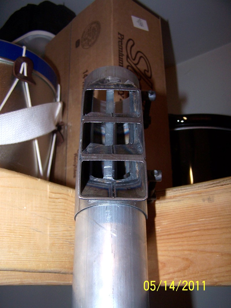

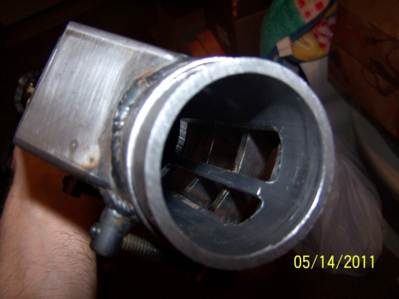

Here is the finished brake. I have a total of 4 hours in it so far. I have not had a chance to fire it yet, however.
I chucked the barrel into the mill vise and milled the slots. Then I slipped the brake over the barrel. It is clamped in place with two 1/4-20 bolts.
A standard compound round passes the first two slots entirely before the O-ring exits the barrel. So, the venting should be good. This brake has far more flow area than most I have seen. It should work well.
To give you an idea of the size of it, I included a picture of the end of the barrel in my hand.

I finally had a chance to test the muzzle brake. It reduces the recoil a noticeable amount. If I had to put a number on it, I would say 25% or so less recoil.
One major difference, however, is the fact that various slug weights has little affect on recoil. So, the heavier the slug, the slower it moves in the barrel and the more venting occurs to reduce recoil.
