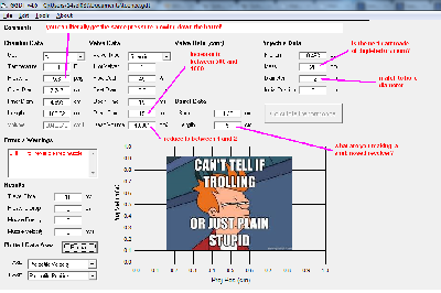

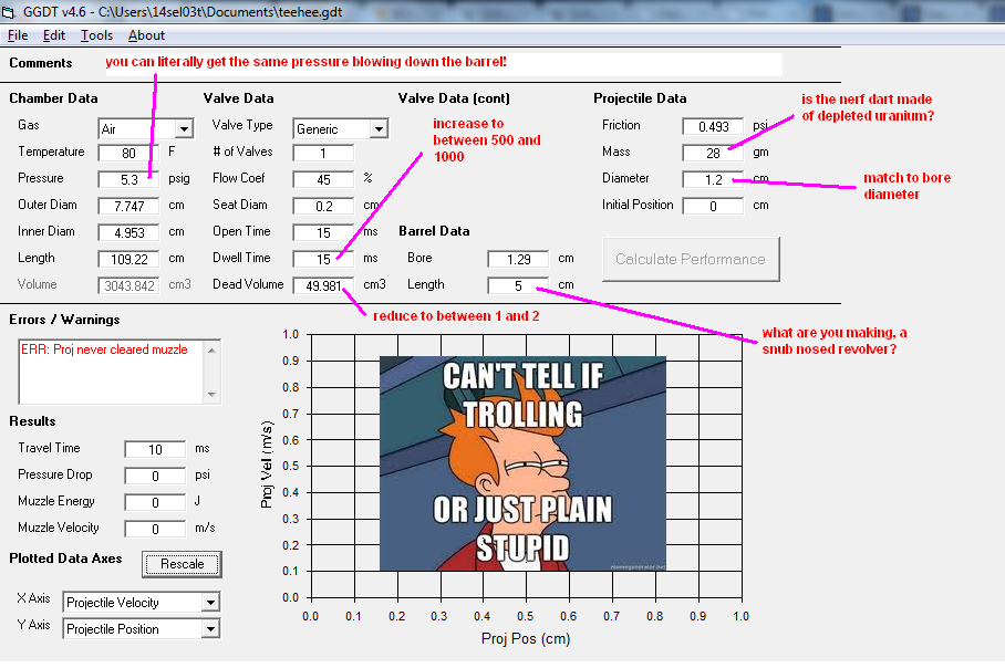

I dunno I'm noob to it so I think you think I'm stupid.
But here goes nothing.
[/img]
Labtecpower
Posts: 1297
Location: Pyongyang
Has thanked: 5 times
Been thanked: 13 times
inner diam should be zero, unless you have planned a coaxial configuration. you should really up the pressure, at least to about 30 to 45 psi. Your dead space is also too big. it should be about 5 ccm.

the thing called dead space put 0 and nerf darts don't way 28 grams? more like 1-2g.
Stormling
Posts: 20
Joined: Thu May 12, 2011 4:08 am
Oh the 28 was an error but it still says it won't leave the barrel.
By dead space you mean dead volume right.

with a bit of stuffing around i got it to reach 1.8m/s maybe the program isnt made for such low pressures and velocities

Turn up the dwell time?

shiny455 wrote:with a bit of stuffing around i got it to reach 1.8m/s maybe the program isnt made for such low pressures and velocities
The GGDT site says is has trouble with low pressure guns.
Some comments...
Technician1002 wrote:Classic example of GIGO.
In this case the GO never cleared the muzzle :roll: :wink:
Or not reading the manual... :roll:

jackssmirkingrevenge wrote:Some comments...
Just plain stupid actually. The thing said that the barrel was unnecessarily long too.
