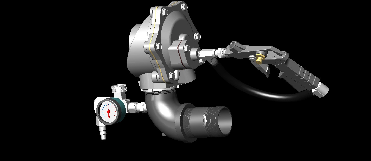

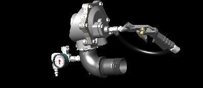

Drill and tap, then install fitting with JB Weld.
The flow control regulator and tire inflator are from Harbor Freight.
I have a male quick connect on the flow control.
All the fittings I ordered from McMaster Carr.

I have ordered pump and some aluminum fittings. I am using a 12vdc air suspension pump from Helix. Will pump up to 200 psi and over 3.5 cfm a minute. So when putting in the regulator, do you screw it directly into the elbow or use a connector? What do you find is the benefit of using this as compared to a schraeder valve? Thought that might be easier to connect and disconnect.

That detail helps, I like that set up. Few ?s for ya.
Why you have a small elbow where you connect hose to fill chamber.
What type of connection do you have between regulator and elbow on chamber?
Is that the make quick connect on the tip there to connect your air source to?

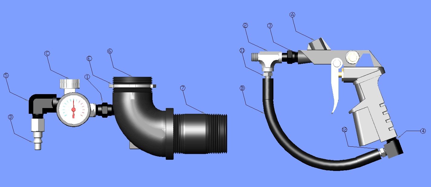

Here is a partial list and drawing.
Item 1 pn 50925K131 Hex Nipple 1/4 NPTF Steel (for 1-1/2 elbow)
Item 2 pn 50925K196 M-F-F Tee 1/8 NPTF Steel (for pilot valve)
Item 3 pn 50925K258 Hex Nipple Reducer 1/4 to 1/8 NPTF Steel (for inflator output)
Item 4 pn 50925K271 M-F 90 Elbow 1/4 (for inflator input)
Item 5 pn 50925K271 M-F 90 Elbow 1/4 (for regulator input)
Item 6 pn 4638K227 M-F 90 Elbow 1-1/2 Galvanized (for valve input)
Item 7 pn 4549K654 Nipple 3 inch 1-1/2 NPT Galvanized (for valve Elbow input)
Item 8 pn 4549K654 Nipple 3 inch 1-1/2 NPT Galvanized (for valve output)
Item 9 pn 2525A113 Tap 1/4 NPT (for 1-1/2 Elbow)
Item 10 pn 50925K271 1/4 NPT Tap
Item 11 local hardware store 1/4 Hose Barb 1/8 NPTF (for pilot valve)
Item 12 local hardware store 1/4 Hose Barb 1/4 NPTF (for inflator input)
You are a good man, thanks a lot, had no idea there were that many parts. Thanks for helping me out, I really appreciate it.
Oh yea, why did you put an elbow in between regulator and fill valve? Also, why did you choose a regulator to fill up tank? Is there another way to fill up tank without having to close a valve first? Just curious why you chose that way.

The pilot air must go to the inflator input, when the trigger is actuated, the air will vent out the old meter port. If not plugged, it would bypass the inflator valve input and trigger and vent out the old meter port all the time!
I prefer quick connects rather than Schrader valves. This allows the compressor to be hooked up all the time or not.
What better way is there for the physical size than a flow regulator when you will still need a pressure guage. If you add a guage and a Schrader valve you need to add two more tapped holes in the chamber thus weakening the chamber. This method only requires one tapped hole and gives you fine control of the fill rate.
The elbow on the flow regulator is to give the air line a vertical connect rather than stressing the regulator from extra weight from a horizontal connect. (When hooked to compressor all the time)
