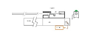

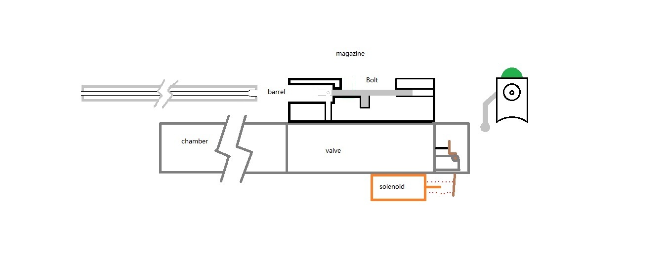

Well, if its two cylinders going into each other, you would have to rotate it until it works, if its built in and pre drilled, well no need to line it up.
Goats spudz
Posts: 458
Joined: Tue Aug 02, 2011 12:31 pm
no you wouldn't you have a 15mm tube and a 15mm barrel both with the same ID of 4.5 or 5.5 mm depending on caliber, going into a 15.01 mm hole it will line up
Where's my Chuck key?
DYI
First Sergeant 5
First Sergeant 5
Antigua & Barbuda
Posts: 2862
Location: Here and there
Goats, I think what warhead is getting at is the issue of concentricity of the bore with the tube for both tubes.
So long as the barrel's bore is sufficiently concentric with its external diameter, this is just a matter of producing the OD and ID of the other part without re-chucking, which will ensure concentricity.
Gippeto
Venezuela
Posts: 2506
Been thanked: 17 times
Keep it simple...drill the transfer port into the barrel...or use a longish flow through bolt. This really does not have to be difficult. :)

Gippeto: What do you think about this?
Gippeto
Venezuela
Posts: 2506
Goats spudz wrote:IIRC the airforce condor reaches 1200+ FPS with room temperature air
Yep, the Condor can reach those speeds...and more. I've seen a much modified Condor shooting .177's chronying ~1400fps and still grouping "fair" at 25m. Was ~ 3/8" ctc as I recall. Would be real deadly close up. :twisted:
But push the range out....and it becomes a truly ineffective shotgun. :(
The owner switched to a .25 setup to make better use of the air he was using...now pesting beyond 100m.
If trajectory is your biggest issue, get chairgun. When you've settled on a pellet and velocity, you enter that data into chairgun and print yourself a handy trajectory chart...if yer real picky, get a range finder to add to your kit.
Edit: You REALLY don't want to drill that hole do ya. :lol: You really won't bugger the whole barrel if you fork up the tp hole once or twice....at worst it costs you an inch or so of length....and you won't fork it up. :wink:
That's the basic idea. The hollow section of the probe should be ~.010" smaller than the lands of the rifling...this will allow you to NOT have to chamber the barrel. (assuming you don't drill the barrel for the tp)
Obviously the barrel cannot be allowed to block the flow to the probe...the receiver block is going to need some alteration to accommodate the transfer port and the probe will need to be lengthened to compensate.
ORRRRR...you could drill the bloody hole in the barrel. :lol:
