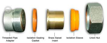

I was about to go out and buy parts for a hybrid but in searching for unions I came across this
union 2.jpg (3.18 KiB) Viewed 7804 times
It's called a dielectric union or something like that (this is the first time I actually came across it XD)
Anyway, most stores boast that it will hold up to only 200 something PSI, I was wondering if this was true or whether it would hold up to 10x mix. This would be a lot easier than finding someone to face down the tapers on a regular union.

It should work, although you'll obviously need to adapt one side to copper tube. Copper tube makes for fairly consistent, safe barrels anyway, so on a low pressure design like this there isn't much against using it. The pressure rating on parts like these usually has more to do with their shoddy tolerances causing leaks than with actual rupture, although, as usual, you should either hydrotest to an appropriate multiple of the working pressure or only operate the gun remotely.
Also note that it's possible to do a pretty decent job of removing the lip from a union by yourself, using only a bench grinder and a belt sander. A lathe would be nicer, but several Spudfiles members have done beautiful jobs of it with only those basic tools.

I might just get one of them (dielectric), I believe Ace hardware had one they called a galvanized dielectric union with threaded pieces on both sides (I wanted to use a piece of conduit pipe for the barrel). If I do find someone to modify a regular one I'll get it (I may or may not be able to get to a bench grinder) since it seems a bit safer and looks to have a little wider flow.

I scraped the dielectric union at the store, I didn't quite trust it. That and I figured I could make a regular union work. I actually found an o ring whilst walking around the plumbing section that fits into the area between the tapers on my 3/4'' union perfectly! I've only tried it up to 60 PSI (haven't sealed the threads on the chamber yet, so it's leaking a lot) and it seems to do the trick.
