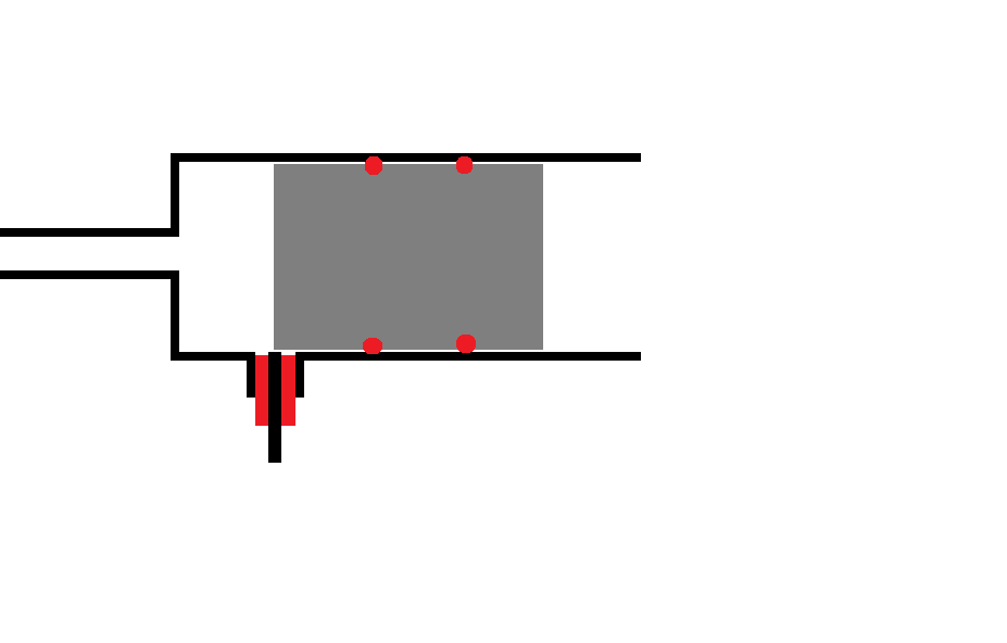

Interesting concept, me gusta! The trouble with conventional dieseling spring-guns is the variability of the ignition timing due to fuel mix, which can damage the piston and cause unstable muzzle velocity. Having the ignition occur at a fixed compression could help solve those problems. Metering the fuel to get a consistent mixture ratio is also going to help.
Sometimes the ignition may fail. Make sure that the piston doesn't damage the spark gap by hitting it. I'd suggest having the spark gap contacts be in the wall of the cylinder, rather than on the face. Make sure they are flush with the wall, and have the o-ring gland in the piston set back from the piston face so that the o-ring doesn't get shredded by passing over the contact. This would also prevent the contacts from being shorted out by gunk smeared over the contact insulators by the o-ring.
You'll need a high voltage capacitor & charging supply, rather than a BBQ igniter.

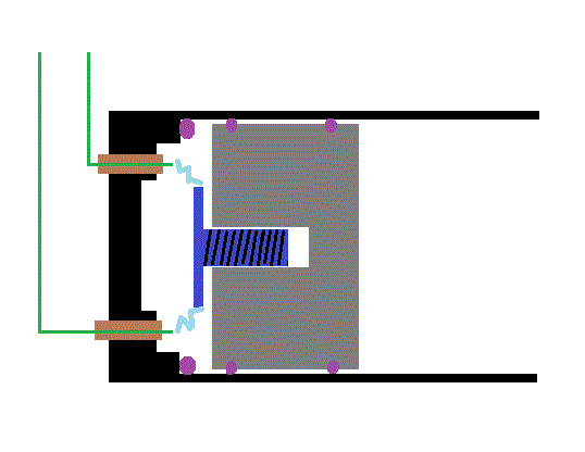

My thinking tries to regulate the moment of the explosion in the shooting chamber. It has a screw, as in the drawing), which can move forward or backward the moment the spark jumps depending on the position of the piston. When the spark jumps later, more compression, when it jumps further back, less compression. I have the idea that the "bridge" that approaches the contacos, (in blue), should support the contact, perhaps using an o'ring to dampen the impact a bit. A matter of testing and drawing conclusions based on the facts. If I have the ignition contacts laterally, I would lose the possibility of being able to regulate all this, apart from that it is much more complicated, because it is necessary to weld the electrode housing to the tube.
