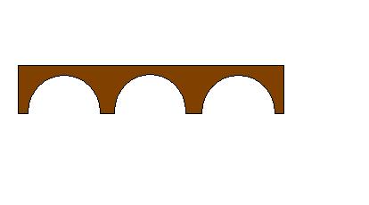

just build a sort of rack for them out of a 2x6 like this and them secure them with rope
