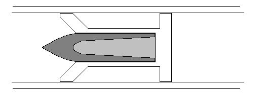

What you should try is an acetal cup with as much material removed as possible to keep it light, then machine a subcalibre penetrator of say 40-50% of the barrel diameter with a hollow tail that fits in the cup loosely enough to come apart in flight.
You should get better penetration and flight characteristics thanks to higher velocity (due to the lower total weight of projectile+sabot) and improved ballistic co-efficient.

Ok i think i can make that! 8)

Thats an idea! Thanks Red
Out of curiosity, had you made the projectile I had suggested above?

No i have not, I did use the basic idea to get through the coins, however it was not "discarding".
I want to use the sabot design in my 33.7 mm but i have so many thing to make- i getted confused at times
