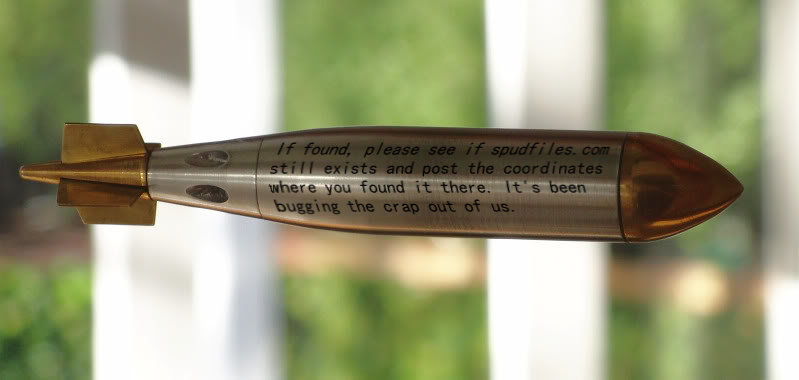

MrCrowley wrote:Since I don't have long between finishing university for the semester and the estimated launch date, I've been thinking about every minor detail of the launch to insure I account for it.
A very important/critical detail for a successful test firing that you have not shown or mentioned yet is where the MiniBoys center of gravity is.
Load it up with your talcum powder/chalk and then determine the balancing point. Measure that point to the nose tip.
32 mm or less would be optimal!

I think there is a more elegant solution to projectile recovery.
Gun Freak
Lieutenant 5
Lieutenant 5
Posts: 4971
That's actually a good idea :lol:

Fnord wrote:I think there is a more elegant solution to projectile recovery.
Haha I like it :D
Similar ideas had been discussed but we never got as far as writing on a .jpg image :P
On another note, what about making a solenoid inside the projectile and trying to pick up the location via interference? Considering the solenoid would be quite small, inside a metal casing and buried several feet under sand I highly doubt this idea is even remotely feasible .
Mr.Tallahassee
Posts: 364
Image That should do the trick! Pick up the frequency on a handheld radio and there it is. 8)
