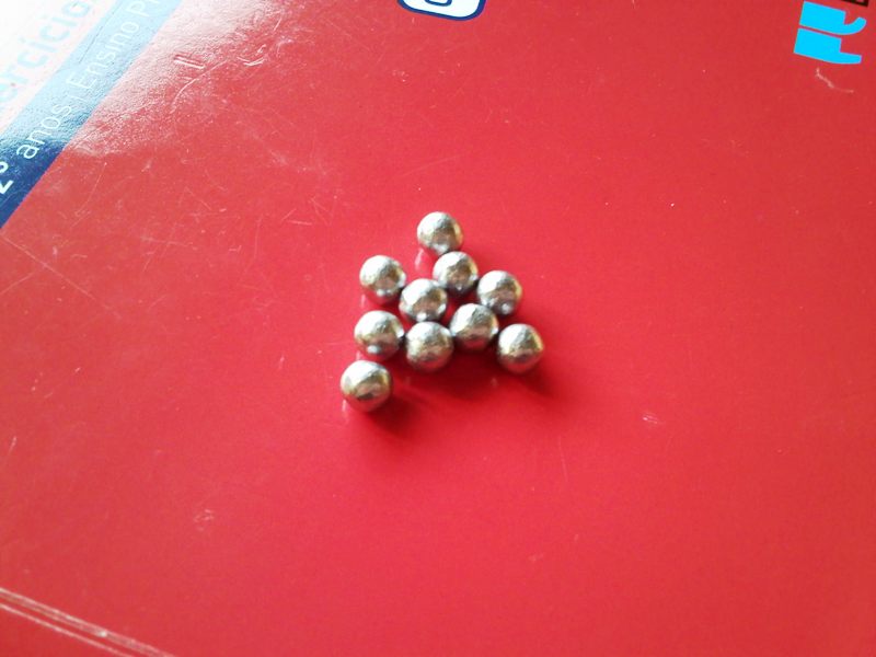

I found a very easy way to make 6mm (airsoft bb caliber) lead balls, anybody wants a how to?
A picture of the lead bbs I made.
warhead052
Posts: 1769
wyz2285 wrote:I found a very easy way to make 6mm (airsoft bb caliber) lead balls, anybody wants a how to?
Wow, those are perfect by the looks of it! Any idea on how heavy they are? And how did you make them?
wyz2285
Austria
Posts: 2388
Location: Porto, Portugal
8g each, I made a ceramic mold to cast them.

wyz2285 wrote:8g each
That doesn't sound right, 6mm lead balls should weigh around 1.28 grams/19.75 grains

Sorry, jack is probably right. I didn't got a chance to measure the weight, so I calculated it from mass density, witch would be +-12g/cm3, then I calculated the bbs size.
But still much heavier than airsoft bbs, I made them for my high power 6mms to get more power, and yes they won't be used in airsoft war.

I probably will make a video.
But it´s simple, I used 24h self-dry clay to make the mold, by using about 8 cm3 of clay with a bb inside, make sure it´s in the center of the cub., let it dry. when it´s almost dried, break it in half, then let it dry completely. So when you put them back to a cube, the join will be perfect. Drill a hole to the cavity, it´s done.
