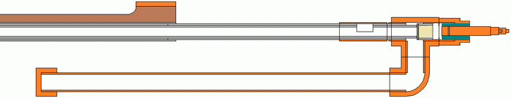

I am going to make a 6 mm gun with a friend.
What do you think of this?
The fill & pilot valve is a presta.
Posts: 3643
Been thanked: 62 times
Well, what can I say, it looks like a piston valve launcher. :P
Any details? Piston materials, operating pressure?
EDIT: One second, jack, one forking second.
Labtecpower wrote:What do you think of this?

piston material: epoxy! filled aluminium tubing with bicycle inner tire sealing face
Barrel: 6 mm ID 8 mm OD aluminium tubing, partially sleeved with 8 mm ID 10 mm OD aluminium tubing.
an internal supressor around the barrel, to make the barrel stronger, and maybe reduce noise.
Chamber : copper, 10 mm ID 12 mm OD, 22 cm long
Posts: 3643
Labtecpower wrote:bicycle inner tire sealing face
BOOOOOOO! :D
Depending on your operating pressure, I would go for plumbing gasketing (the red rubber sheeting). Of course, insane pressures call for something else entirely, but I note you still haven't stated the operating pressure. :wink:

operating pressure: as high as possible :)
(I want to keep al my fingers on, however)
i'll turn a nice piston out of a piece of teflon, if I can get my hands on it.
To get a nice seal, would a cone shape be practical?
Also, could a piece of HDPE replace the teflon?
Posts: 3643
Well, the whole piston doesn't need to be teflon, just the sealing face, and I do believe they sell teflon washers. No sense in making the whole piston out of teflon, unless you like the low-friction aspect.
At higher pressures, pretty much any softer plastic could be used, but durability is a concern.
Also, you'll have to put in a little more work towards getting sealing face on the end of the barrel/pipe as square and smooth as possible.
Pay no attention to that grumpy efficiency Nazi behind the curtain ;) You probably wouldn't notice the difference in performance from my suggested mods without a chrony, and yay for epoxy and integral suppressor :D

okay, here is the final design:
I'm making two of these in a while.
The guns will be painted matte black.
Looks good, I presume the diagram shows the hammer in both cocked and fired positions?
