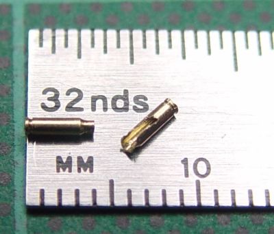

Well, this retrorocket was collecting dust... It's about 4mm diameter, a tad smaller than a BB pellet.... I could fire itBut now you have to make a nano-boy for a future project

I already have some brass casing:

LeMaudit wrote:I already have some brass casing
MUST HAVE LATHE AAAAGH!!!!!

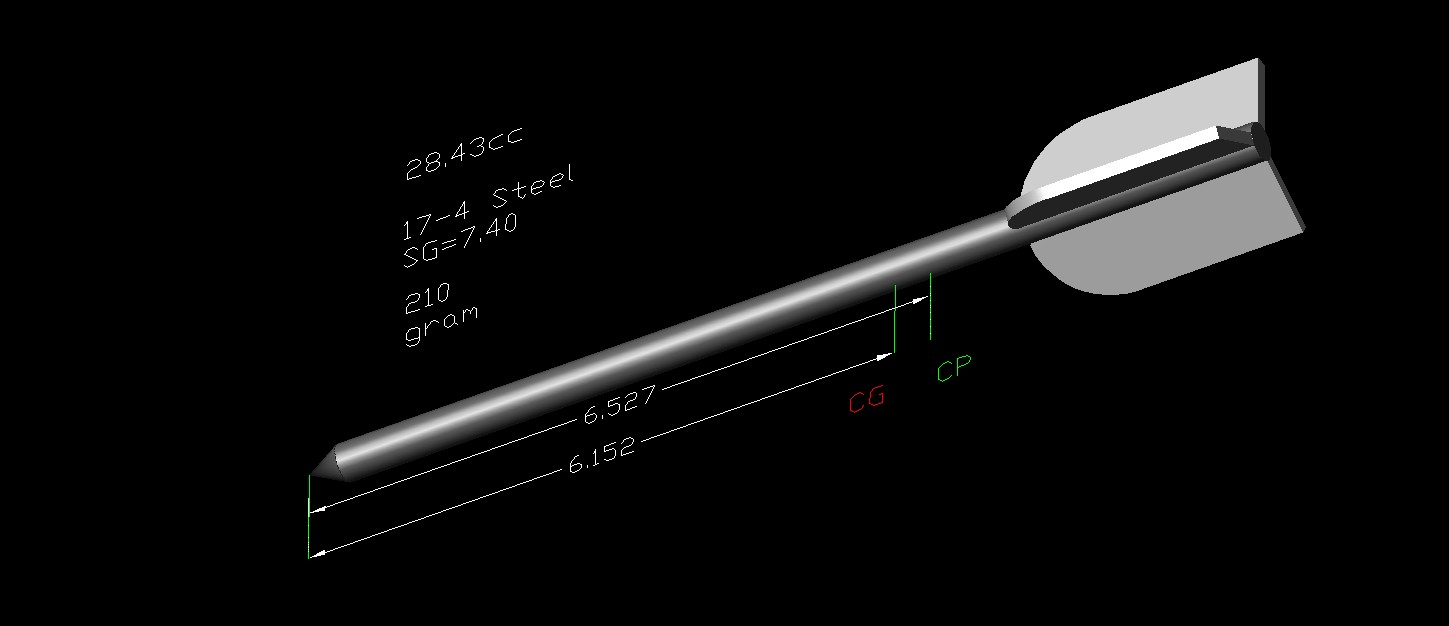

After a little bit of penetration testing, I have decided to fire my custom made round for distance. The problem I am having is that I do not know how to calculate the drag coefficient. I thought you guys might be able to help. The rod is 3/8" in diameter by 10" long with 3, 2.5" by .75" fins welded on to it. I realize the probability of recovery is very low but a drag estimate would be useful. If you need any more information, let me know.

A bit difficult to calculate, is usually determined experimentally.
Looks like it will go far though, what are you shooting it out of? And what does the sabot look like?

... but the fins are pretty huge so the centre of pressure is very far back.MrCrowley wrote:Isn't irisher's projectile too tail heavy?
I actually thought it would never work after I measured center of gravity but I have had great success with this round. The sabot system is short dowel wrapped in duct tape as the pusher plate and carved Styrofoam as the guides. I am firing this thing out of my 1.5" sprinkler gun.

Here is the CP based on 1/8" thick fins.
The CG should be at least one caliber 3/8" ahead of CP.
irisher, where is the actual CG?
