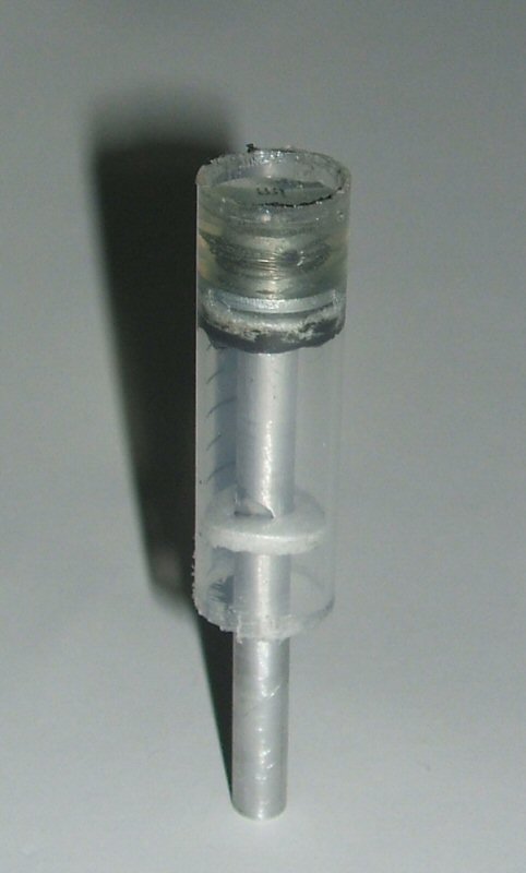

Here's the new heavyweight (around 450% of the original) bolt in its syringe tube mould as I wait for the epoxy to cure. You can see the steel washer i included in the casting for extra strength and weight, as well as the extra foam ring half way around the bolt temporarily added to to keep it centred in the tube. Maybe I should write up a bolt casting how-to? :roll: :D
I don't think there is any need to just keep everything centered btw thats a good looking bolt so far.
spudchucker wrote:I don't think there is any need to
I know, hence the :roll: :D
Should be ready for testing some time today, let's hope it works - or at least, gives an indication that it's close to working, then I can make an even heavier bolt.
