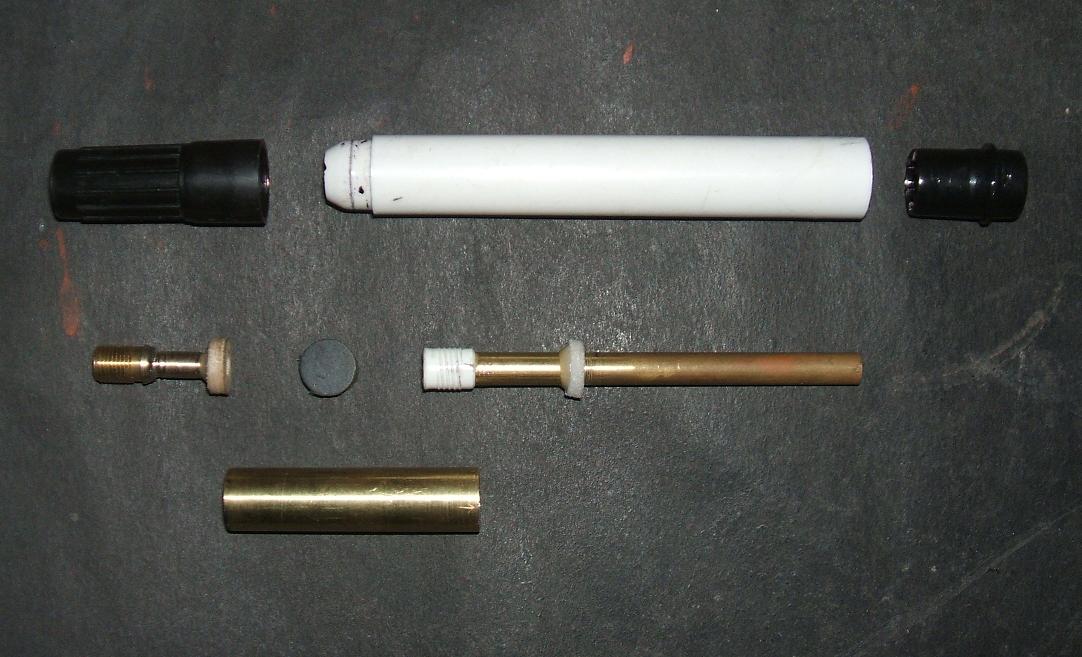

I've decided to give this concept another go, with some modifications:
- metal chamber to avoid the epic fail that afflicted my first version, and to allow it to be used at 800 psi
- true 0.22" barrel as opposed to a 6mm calibre
- all rubber piston stamped out of a 5mm rubber sheet as in my pengun v2
Here's the parts before it all gets epoxied up. One thing to note is that since it will not be servicable, I've added a plastic collar to the barrel to widen the piston seat and reduce stress on the piston.
It should only give around 3 ft/lbs with a 0.22 pellet at 800 psi, but still much more powerful than the pen gun.looks good can't wait to see some results

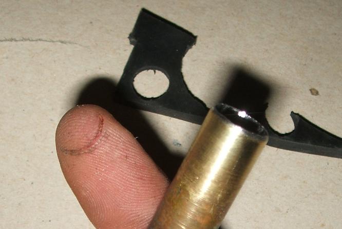

A couple of millimetrestheBOOM wrote:Looks nice how much will the piston travel?
Simply take a section of chamber tubing, clamp it in a drill and sharpen it with a file. You can then either take the tubing out and hammer out a section of rubber (on a soft surface like wood or cardboard) or leave it in the drill and "punch" it out carefully. If you leave the latter method, be careful...how exactly did you "stamp" it out?
Yes, silly JSR was feeding the rubber into the drill as it was clamped in a vice, not the recommended way of doing thingstheBOOM wrote:Dang that had to hurt.. was that your finger, at first I thought it was a finger with no fingernail
No idea what it is exactly, just some scraps I found at work. Looks like neoprene.Is that rubber neoprene rubber or something else?
