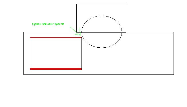

yeah, you definitly need to figure out a bolt/mag loading system, maybe an angles bolt so the BBs get pushed down intot he barrel? so the angle would be like / if the mag/hopper was to the right of the bolt? or this angle \ so BBs not fully into the barrel would just be pushed back up (but maybe a partial angle would be better.. let me draw a diagram!
- angles face would push partially loader BBs up, preventing chops (although not misfires)
- bolt.JPG (10.94 KiB) Viewed 3080 times

I made just that.But I used a block of aluminium.So all channels are drilled, wich makes the points where they cross sharp.

LOL sounds like you have it all under control!So there..
(but i don't get why the angled bolt doesn't work, is it because the lips of the mag tube are sharp?)

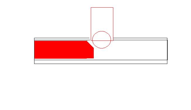

Wow you aren't very good with ms paint.
- My interpetation.
- untitled.JPG (4.67 KiB) Viewed 3067 times

Yep.
Plus the tube the bolt is made out of (5mm antenna material) is just too thin to put a really big sloped edge onto.
I cut it with a pipecutter, wich made the front bend inward, so it should
push the " second" bb up, but it doesn't becuase of the speed of the bolt.
and the fact it is hollow.
It has to be to feed air.
that is something you guys forget in the diagrams!
It just cuts em up.

the angled bolt doesn't work because the edge where the mag meets with the barrel is sharp, and the BB still will get caught on it. The obvious solution would be to round it out a little. It seems like figuring out a way to get it to work would be realllllllly worth it, because of all of the wasted air in a vortex... even with BtB's stripped down version, all of the air going into the chamber is basically wasted.

I know what you are trying to tell me, but the feed problem is because of the HOLLOW bolt.
And the cut down version will be a mayor improvement, it will never misfeed, cut up, or cause jams.Plus it is basically done already...

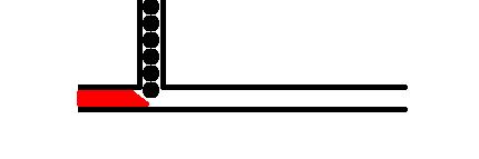

Wait I'm a bit slow can you make a pretty diagram to exsplain why the hollow bolt is the problem?

i will do it gladly
- aS u cun sEa, i haS trIEs extra hard to maek thiz diagrim go0d
- bolt 2.JPG (12.85 KiB) Viewed 3029 times
