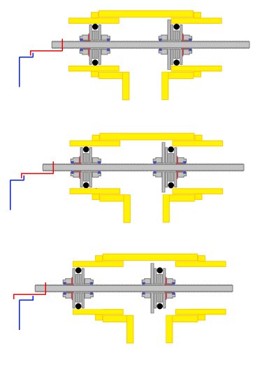

If you want to modify the piston and trigger rod so the piston can move without slamming the trigger back, take a look at my video that shows how it is done in my Marshmallow Cannon. The link to the video is in my sig below under the Competition QDV Cannons.
I did this out of necessity on the larger cannons as the piston force exceeds 100 lbs when triggered. I didn't want broken hands.
In pretty much it's simplest form, what you need is a way to 'trigger the trigger'.
Attach something to the valve rod.
Now, use the trigger you have, to pull back on that something.
But have no connection between the two. So that, once your trigger pulls back on the valve far enough to start it opening, your trigger stays in place, and the valve continues on it's merry way without affecting your trigger.
Here's a crude example, using your own valve pic.
- Your trigger (blue) pulls back on attachment to valve (red) until valve starts to open.
Then valve opens, and valve and red part go on their merry way, without affecting your trigger (blue). - trigger.jpg (22.48 KiB) Viewed 5678 times
