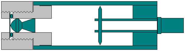

velocity3x wrote:I notice you added epoxy around the schrader in your design. I guess old habits die hard. :P
The diagram is one I posted back in 2007, my idea was that someone would do the machining part beyond my facilities but I would save them work by making the endcap myself. I would still do it if I was making the hybrid cartridge as the shrader would be attached to the electrode and would therefore need to be insulated from the cartridge body.

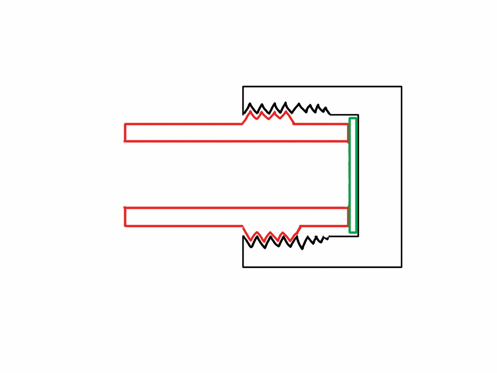

Making the burst disk holder the way you designed would be pretty easy, all i would do is is have a section after the male threaded portion that is smaller than your tap hole. This way you can just use a standard tap and the longer non threaded portion will seat on the burst disk before you reach the bottom of the threads.
If that didn't make sense I'll do a quick picture

jor2daje wrote:Making the burst disk holder the way you designed would be pretty easy, all i would do is is have a section after the male threaded portion that is smaller than your tap hole. This way you can just use a standard tap and the longer non threaded portion will seat on the burst disk before you reach the bottom of the threads.
Normal pipe threads are tapered so they become tight as they screw together. You can use a plug or bottoming tap to make the cap with even threads all the way to the bottom. Then the pipe can be threaded the same. This will permit screwing the pipe all the way in to the burst disk.
http://en.wikipedia.org/wiki/Tap_and_die
Bottoming tap or plug tap:[2] The tap illustrated in the top of the image has a continuous cutting edge with almost no taper — between 1 and 1.5 threads of taper is typical.[3] This feature enables a bottoming tap to cut threads to the bottom of a blind hole. A bottoming tap is usually used to cut threads in a hole that has already been partially threaded using one of the more tapered types of tap; the tapered end ("tap chamfer") of a bottoming tap is too short to successfully start into an unthreaded hole. In the US they are commonly known as bottoming taps, but in Australia and Britain they are also known as plug taps.

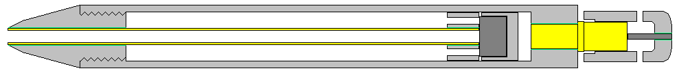

I drew up a pen gun design that I think would make a good first project. The light grey parts are aluminium, yellow are brass and green lines denoting an epoxy join (see! ;))
The breech ring is a collar with o/d = chamber i/d and i/d = barrel o/d with a ring of ports drilled through it. while the piston is an aluminium "cup" with a rubber insert.
What say the gentlemen of the board, feasible for a first timer?
inonickname
Posts: 2606
You'll have more problems that you expect cutting those threads into a thin wall, and even more of a problem sealing them. For a first time project I'd omit the threads. The rest is easy.
Keep in mind it has to be made- that hole won't have a flat bottom, it's going to be tapered unless you find an endmill or counterbore about 150mm long in that diameter. Don't try make your walls too thin either.

The threads would look more like this:
I would make it serviceable from the back, for easier piston reach. Also, keep in mind that the inside of the tube won't be very smooth, unless you ream it after drilling.
and, if you have access to a lathe, why not put a nice o-ring on the piston :roll:

Yeah, the inside will be rough as guts. I'd find a moderately walled Al tube and work from there.
inonickname wrote:Yeah, the inside will be rough as guts. I'd find a moderately walled Al tube and work from there.
hmm... so it wouldn't be suitable to run the piston in, even with some polishing? Again, I'm completely new to this so forgive my abject ignorance...
... because friction would probably outweigh the small benefits of sealing as opposed to just using a finely matched piston/chamber diameter.

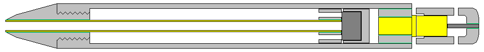

I modified it slightly with a thicker threaded bit and the schrader part made separately and epoxied in. It's important to have it threaded, otherwise what's the benefit of using a lathe? edit: LeMaudit rightly pointed out that with the thread shown it would not be servicable anyway :oops:
