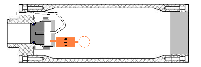

big 4X chamber concept

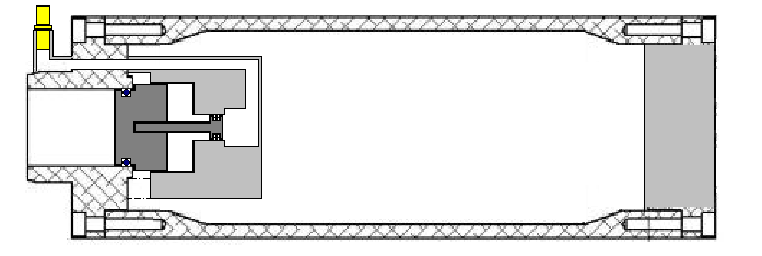

Same concept but altering the geometry
- sawnoffpiston3.png (36.09 KiB) Viewed 3600 times

It doesn't. The valve opens on the chamber rise in pressure. A pop off can be added to the tube and valve act like a dashpot, but it won't fully vent. Due to mass and motion, the valve will pop open and the opening valve will increase the valve dwell time well beyond what a massless piston would provide. Due to the pressure involved, the projectile should be well on it's way downrange by the time the piston rebounds and closes due to the pressure in the pilot. The pop off can be internal to the chamber so it does not pop off while filling, but would pop off when fired and the chamber pressure drops while the pilot pressure rises due to compression. This would aid the dashpot in reducing stored energy in the pilot when fired. It would also prevent an accidental discharge due to overfilling the chamber and having a pop off vent the pilot.But how does it vent?
- Internal pop off valve to dissipate the pilot stored energy

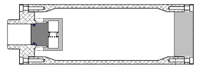

- sawnoffpiston2_407.png (30.93 KiB) Viewed 3589 times

Interesting. You don't think the valve would spring back closed before the pop off has a chance to allow any venting? I was thinking of having the pilot isolated from the chamber for two reasons. One is to allow opening pressure adjustment independent of chamber pre ignition pressure, this can fine tune performance. The other, is when the pilot is compressed by the piston, the pop off will be outside the chamber at atmosphere to allow a quick burst of air pop through. Maybe this will reduce the violent rebound of the piston as well as increase dwell time as you suggested.
The pop off can be an adjustable one, so it can be set to be equal to the pilot pressure so that it opens at the slightest increase. Assuming it doesn't dump too quick, it can also be used as an easy signal to let me know the pilot is up to pressure. Once the pilot os up to pressure, the valve would pop.
Being an isolated design, I could fill the pilot first and this would eliminate the risk of an accidental discharge of pre ignition gasses.
Once I actually try out the pop off valve, I might very well decide that its useless and remove it. Who knows. I could then replace it with a drain cock or push button release valve for pilot drainage, that way I can maybe vent the chamber without the piston blocking the way.

Instead of a pop off valve a spring loaded check valve could be used. The advantage would be a low pop pressure of only a few PSI and a large valve seat. The piston moving into the pilot compresses the gas. Venting that will reduce the rebound. Venting to the chamber will give a short flow path, a large opening, and enough restriction to arrest the piston movement in a dashpot configuration. The spring would be used to hold it closed while the pilot pressure is used to close and seat the piston.
How about this variation, the piston is spring loaded and a tight fit but with seals only at the barrel. During filling, the mix can flow to the pilot area so eventually it all equalises. On firing, the pilot area dumps into the firing chamber.
Not sure it would work, just one of those at-work-and-busy-but-not-concentrating brain farts

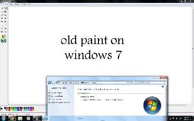

download this it is great way better then the window7 paint.Also at this time I'd like to point out GODDAMMI$# $#%#OFA!$#*&)^$FUC%^ YOU MICROSOFT!! I WANT THE OLD MSPAINT BACK!
I'm a pc, and windows 7 was NOT my idea!

Then with the heat of compression of the fuel air behind the piston, the secondary explosion shatters the piston and ejects shrapnel out the barrel..jackssmirkingrevenge wrote:During filling, the mix can flow to the pilot area so eventually it all equalises. On firing, the pilot area dumps into the firing chamber.
We decided to purge the fuel from behind the piston for a reason.
In regrds to paint, at home I prefer The Gimp.
Where's your sense of a adventureTechnician1002 wrote:Then with the heat of compression of the fuel air behind the piston, the secondary explosion shatters the piston and ejects shrapnel out the barrel...

Now that sounds pretty good. It would eliminate an isolated pilot, but maybe thats something I should live with.Technician1002 wrote:Instead of a pop off valve a spring loaded check valve could be used. The advantage would be a low pop pressure of only a few PSI and a large valve seat. The piston moving into the pilot compresses the gas. Venting that will reduce the rebound. Venting to the chamber will give a short flow path, a large opening, and enough restriction to arrest the piston movement in a dashpot configuration. The spring would be used to hold it closed while the pilot pressure is used to close and seat the piston.
EDIT: My concern with ditching an isolated pilot is that i'll be stuck with whatever opening ratio I initially choose. If friction or other unforseen things hinder valve performance, I won't have a way to adjust it from what I can tell.

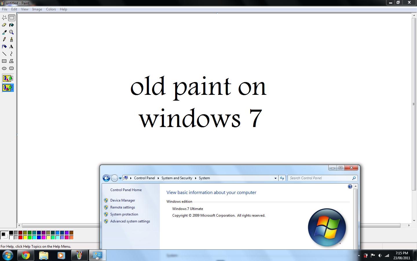

I laughed really hard at that..... errrhem! back on topic.Fnord wrote: I am now using an LCD screen, but I think I'm going to switch back to CRT... I miss being able to slam my fist into the screen when I have technical difficulties.[/size]
I found that an adjustable pop off vented to slowly to bother with would not even pilot a 3/4''QEV.
If i was you, i would pilot the piston by building a simple spring loaded hammer valve that vents to atmosphere. hit by the piston.
The spring strength could be significantly more that what is needed to hold it shut under pilot pressure, as the piston would be moving with such force, it would have no problem opening it.
"stock xp" ms paint diagram on the way!
EDIT:
EDIT again: More suited to the shape of your launcher.

(First post from the new desktop!) its a windows 7pc.... paint for windows7 DOES blow!
