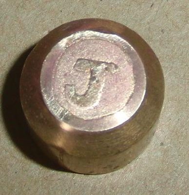

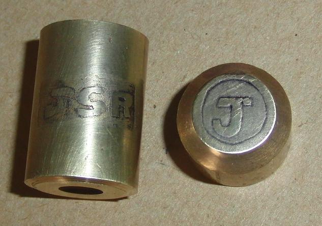

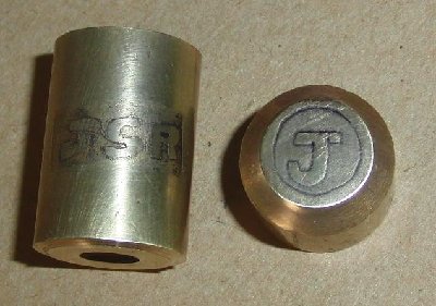

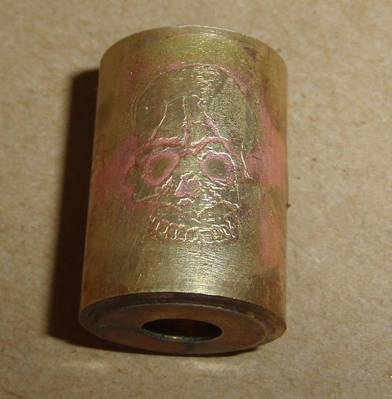

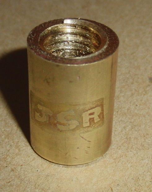

Some etching experiments, using concentrated nitric acid on one piece and the hydrochloric/peroxide mix recommended in jake's link. In both cases I used nail polish (from my own personal collection, naturally
) to mask the design.
Unsurprisingly the nitric went much quicker and bit deeper. I don't have the chemicals required to black it but used some ink and gave them a light polish, really happy with the effect
) to mask the design.Unsurprisingly the nitric went much quicker and bit deeper. I don't have the chemicals required to black it but used some ink and gave them a light polish, really happy with the effect

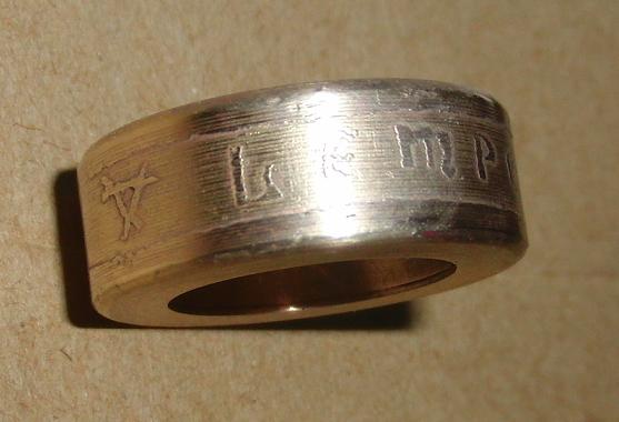

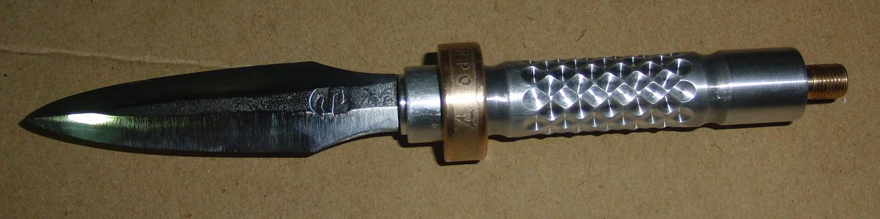

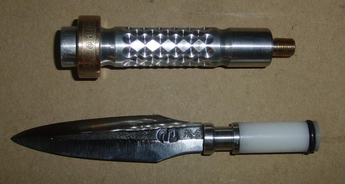

Here we go, a simple brass ring with some acid etching, much more comfortable to shoot now. I also redid the knife tail with a lighter aluminium support.
I'd like to black or otherwise colour the collar to bring out the lettering, need to consider options. Also needs a discreet stop for the collar to stop it falling off everytime I shoot it

great work as always! the collar looks like it does help alot
Cheers

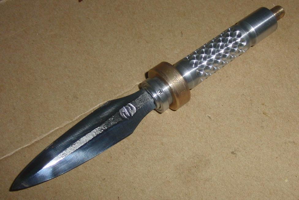

Some more work, added a front stop for the collar, and ordered a bottle of this stuff to blacken the collar and highlight the etching.

nice, looks much better now
the blade fits to it better now

Much better ring
It looks a lot nicer than the previous one...
Agreedjakethebeast wrote:the blade fits to it better now

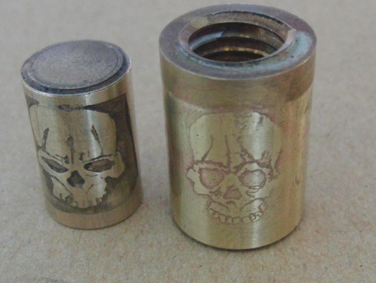

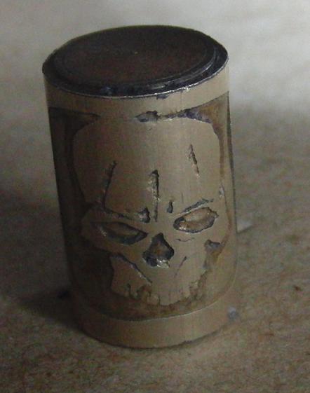

Had some fun with etching in the meantime, damn this focus on aesthetics and my artistic streak forcing its way out of the cellar I had confined it to! I have engineering to do aaaughhh!!!!
Long storyjmez1996 wrote:What are the symbols on the ring?

Damn, those skulls look sick!

wow that final skull looks insanely cool!! what are the things your etching on?

Nice skulls indeed

I think they're past sickGun Freak wrote:Damn, those skulls look sick!
Scrap pieces of brass, just playing with techniques at the moment.what are the things your etching on?
