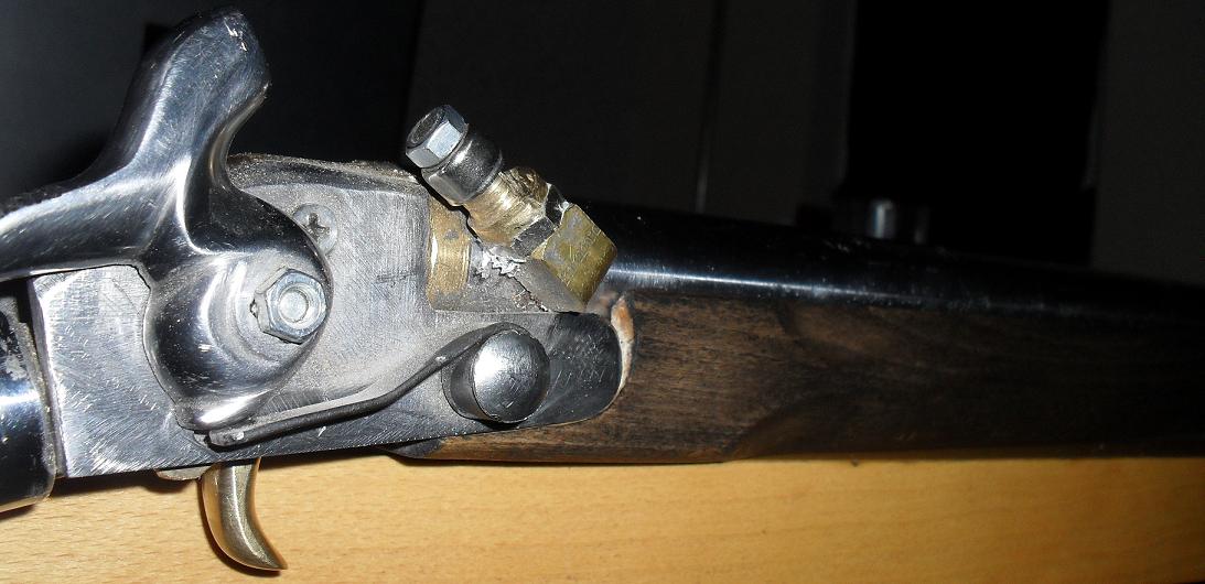

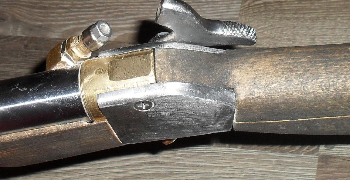

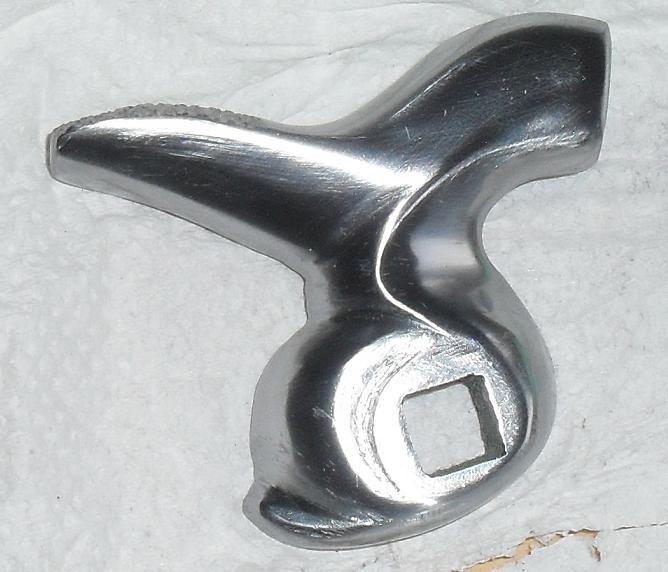

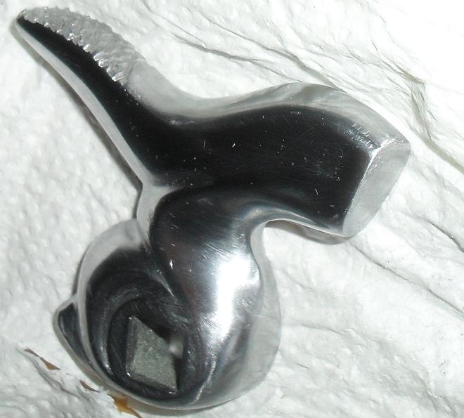

I drilled two small holes, or dimples if you will, in the back of the hammer and inserted ballbearings.
Runs smooth as a...as... eehm...asif it's on ballbearings...
I made a tumbler or sear to lock the hammer in cocked position...took me WAAAAAAAAY longer than I imagined...
Just about everything gets in the way in the tiny space but after a lot of tinkering I figured out what the shape should be to both work and fit in and around everything....Made 3 prototypes and I was up till 3 in the morning trying to figure it out...
- Brian the brain
- Posts: 3497
- Location: Holland
- Been thanked: 7 times

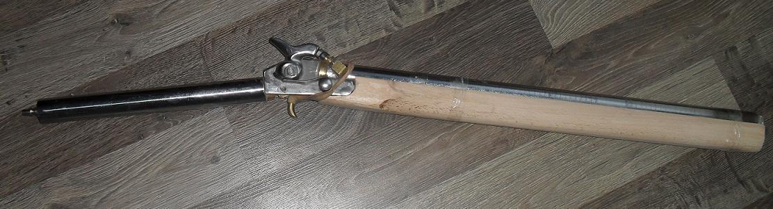

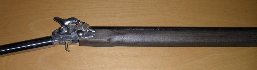

So...trigger is roughly done...
Now it's time to start shaping some wood.
More than half the weight of the original block was removed to shape the front section.
And I haven't even finished the final fit onto the action.It'll move back into the steel as I cut out the exact shape needed.
I used a speeddrill-bit to dig out a channel for the barrel to fit into by overlapping the holes.
That took care of the bulk...
Then I took a piece of the original forkleg the barrel ( reservoir really) is made from and sharpened it.
I attached a bolt as a makeshift handle and voila!
A woodplane in the shape of the barrel.
Worked wonders if I do say so myself.
It enabled me to cut a long halfpipe-like channel from the wood.
Then I used a regular woodplane, a grinder with sanding discs and finally 120 grit sandpaper to form the front-stock.
After that I tried what I had been wanting to do for quite a while...although I had no idea how it would turn out: Staining the wood.
What did I use?
Liquid shoepolish ofcourse!!
And I oiled her up with some cutting oil.
Turned out way better than I had imagined!

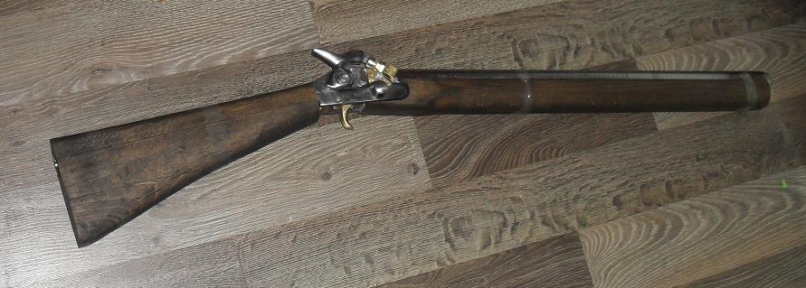

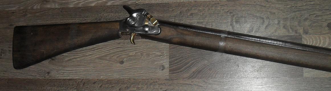

I made a shoulderstock...took me two nights...
Still rough, but I still stained it.
It'll help me to visualise what I need to do.
After final smothening and sanding I'll rub some more shoepolish on there..
I think I pretty much nailed the overall shape though.
It already looks like a real donderbus.
That's what they were called you know.Not what the English thought we called them.
Blunderbus?
Blunderbus?
