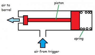

Why not an off-the-shelf QEV and pop-off?
Wait, are you planning something like this?
Never had much luck with this configuration, they all cycled way too fast to be useful.

I figured if I made my own, I could increase the volume of the chamber?Why not an off-the-shelf QEV and pop-off?
