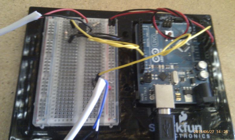

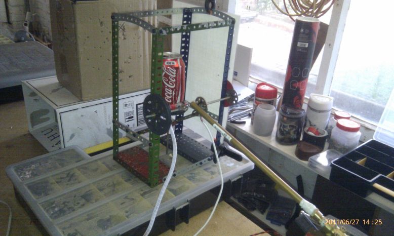

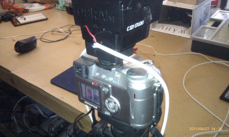

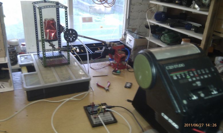

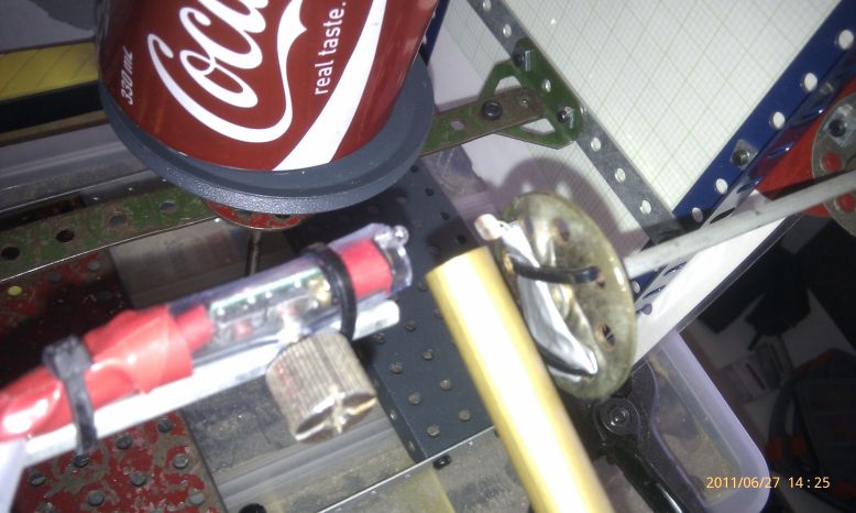

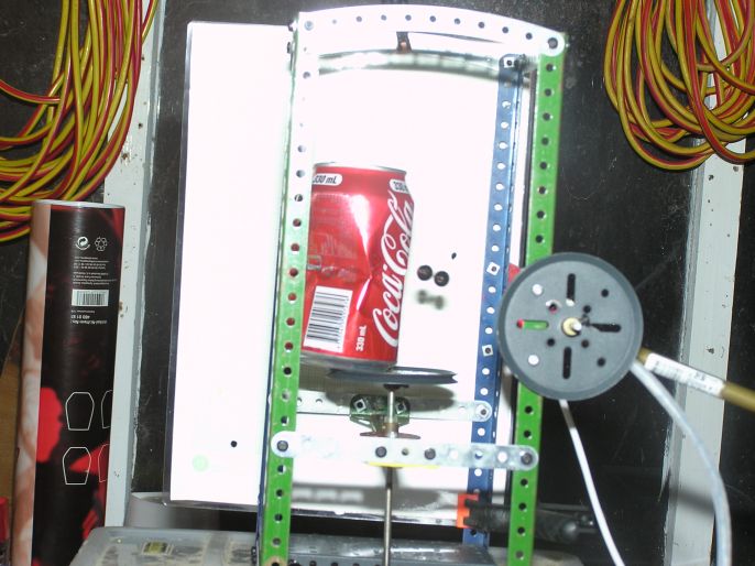

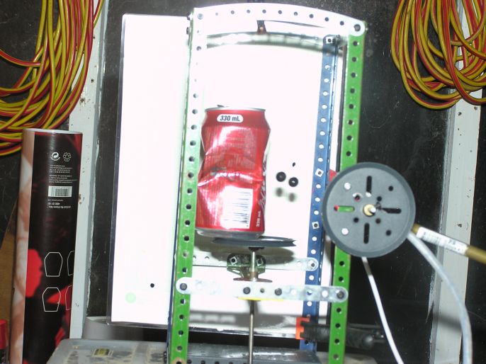

Caveat: None of this is new, this stuff is all over the Intergoogle and all I have done is pull together a few disparate threads and tie it into a pneumatic related post. It may be a high speed camera now but with some work it can also be a chronograph, all for a total spend of about $45.
Right at the start of this thread Insomniac said "More and more members of spudfiles are getting access to high-speed cameras".
I don't but I do have a way that might be of interest to others.
If you can't get a high speed shutter, get a low speed shutter and control the light source instead.
1. Arduino Uno board
2. $2 laser pointer
3. Light dependent resistor
4. Lots of Google
5. Two bottle of a rather good 2008 Shiraz
Mini howto:
Set the camera to 5 second exposure in a darkened room.
"Modify" the flash gun to disable the hot shoe and take it's power from a Nokia phone charger.
Wire the flash gun via a solid state relay to protect the micro controller.
Point the laser diode at the LDR and read the output value.
Fire the camera shutter by remote control to avoid shake.
Fire the solenoid to launch our projectile.
When the LDR drops below a threshold the beam must have been broken.
If so close the contacts on the SSR and fire the flash gun.
I played with the Arduino code and can vary the delay between the beam being broken and the flash firing.
Photos below, my first attempt at firing 10mm plastic BB's from 300mm of brass tube at 1 bar. I need to work on tuning the LDR to cope with sub millisecond variations so I can move to 8-10 bar with corresponding muzzle velocities.

With a small change, you can trigger multiple flash units in sequence to capture the distance traveled between flashes for a visual chronograph. I'm working on a version in my spare time using flash units from disposable cameras.
The LDR tends to be a relatively high capacitance item so the response is somewhat slow. If you use the high speed photo diode with low junction capatance, you can get very tight times. Salvage one of those gems from a broken CD player. They are very high speed in relation to a LDR.
A note on the relative speeds is in this forum;
http://www.dutchforce.com/~eforum/index ... opic=22315
At full blast (10 bar)they perforate the can and do a fairly good job of adulterating the backstop. Trouble is they transit way to fast to trip the LDR. I think I can see them in motion so maybe 30-40 metres per second the low pressure I am testing with.

Maybe one of these ??Technician1002 wrote:If you use the high speed photo diode with low junction capatance, you can get very tight times.
http://www.jaycar.com.au/productView.asp?ID=ZD1947
