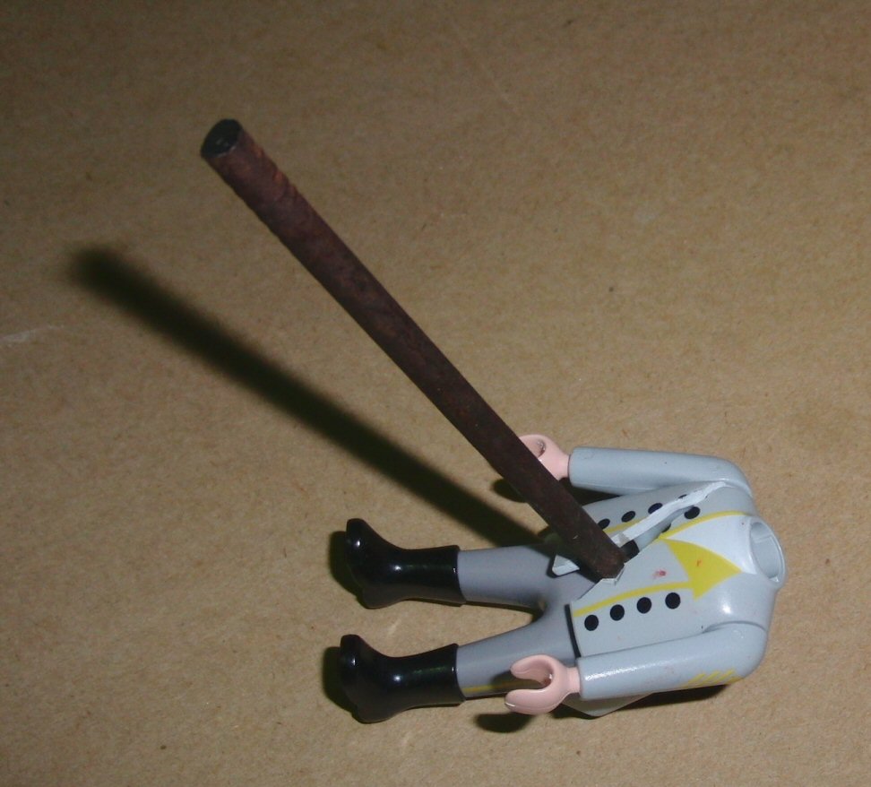

Not going to publish this particular protoype but here's a couple of test shots in case you were wondering my lathe was idle ;)
LeMaudit
Posts: 665
hahaha... kill Playmobil KILL KILL!!!!
Sparkling!! 8)
I HAZ A BANG!
The recovered "corpse" was actually quite amusing :D
