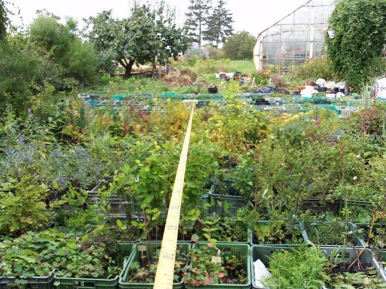

a couple of minutes after writing this post I found a measuring tape in my basement... so I wanted to check the exact distance...
it turned out it's a little bit further than 19 meters from where I fire to the place where I put my targets...

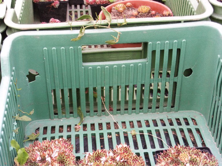

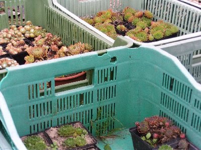

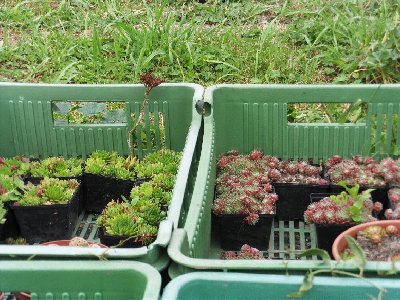

I made a few collateral damage pics (aka DYI backstop syndrome) as well...
now you know why my mother doesn't approve of my hobby... :wink:

ohh btw it seems that 'FILE0069.JPG' in my previous post clearly proves that ammo travelling at high speed makes smaller holes
A high speed projectile does not give the target time to react, and in a solid medium will leave a projectile sized hole. A slower projectile gives time for stress to be placed at areas further away from the point of impact resulting in a bigger, fractured hole in certain media such as plastic in this case.

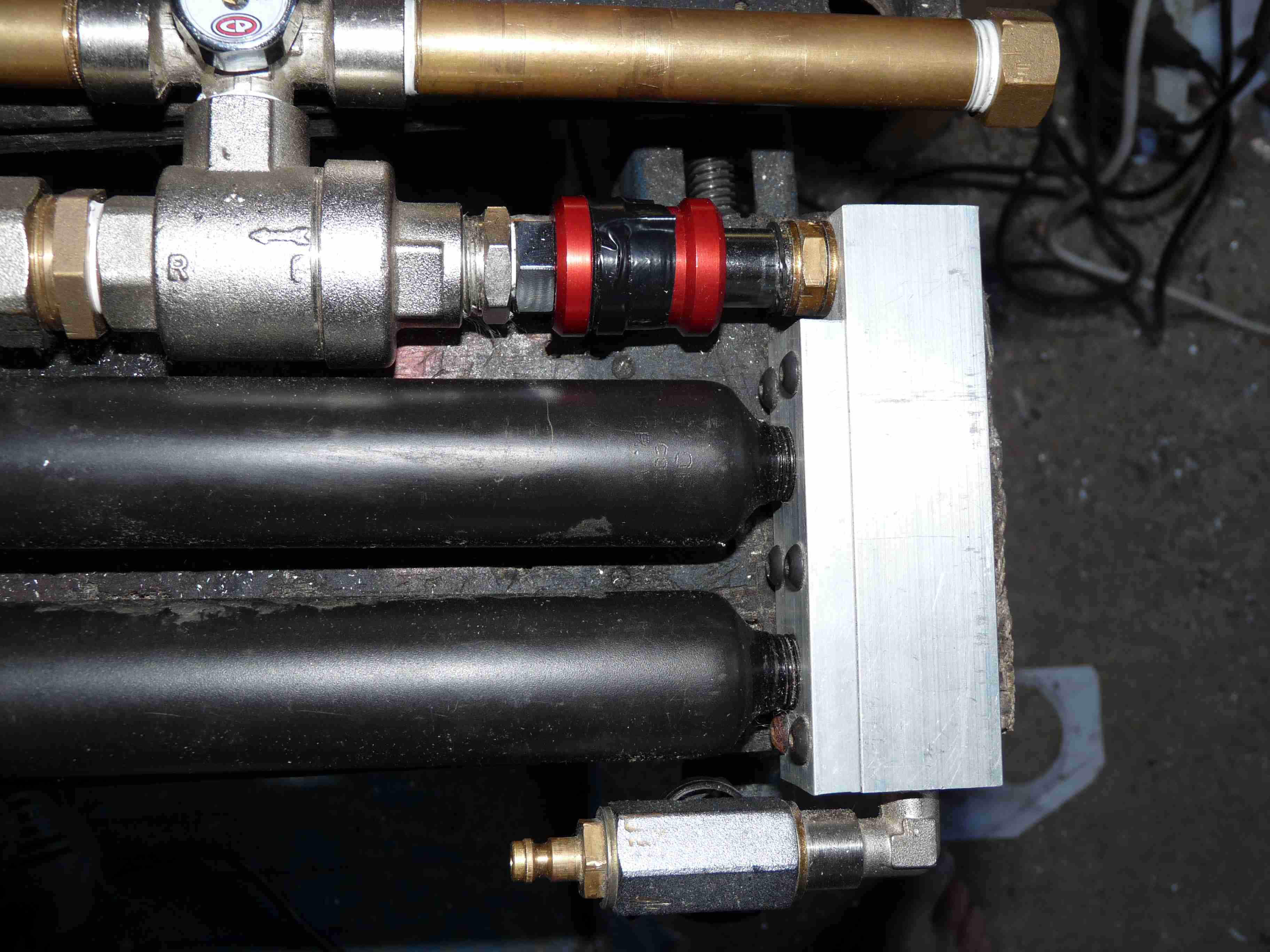

I bought a tap and made a manifold, the thread doesn't form a seal just pushes the neck down on an O-ring. It was initially designed to be able to pierce a full cylinder but I chickened out for now and use it with air at 600psi. The modification should be simple to make though just tap a hole in the back for a sharpened bolt.
photo showing manifold with threading for 2 x 88g Co2 cylinders, ball vallve and slide valve.

As of yet unfinished, It will actually work on a similar basis to yours, there is a piston in the brass section of chamber above the slide valve which connects to a moving barrel through the rest of the chamber and loads a round whenever the chamber is pressurised. The two 88g cylinders are a reserve chamber which fill the main chamber when the slide valve is moved. I tried a regulator as well but the flow was crap after a few shots when everything cooled down. I'm to scared to try unregged yet, If i ever get it working well I might invest in a remote paintball CO2 setup, keeping the two 88g tanks as a buffer chamber. For now I just use my pump.
What's taking so long is the magazine and breech, saboted darts are a bit tricky to feed automatically...
