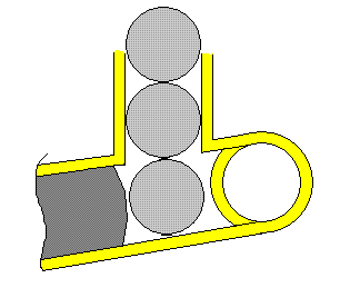

I was thinking of a side feed mechanism like this (viewed from the front as a barrel section) The dark grey plunger would be connected via some sort of cam to the pop-off piston, pushing a BB into place at the moment of firing while blocking off the magazine.

I think your plunger's shape should be: ( instead of )
Blow-sideward valve lol.
Dont forget that the pressure may push the plunger back.

Not if the pop-off piston is mountad sidewards and the plunger is directly attached to the pistonpsycix wrote:Dont forget that the pressure may push the plunger back.

I had an idea for something similar.. IMO it's the best possible way to load ammo since it doesn't restrict flow... (ofcorse the plunger should be longer than it is now)
I had some problems with flow restrictions casued by bolts and my conclusion is that blowforwad bolts will work but they won't give you good performance...
this seems to be esspecially problematic for smaller guns as it's more difficult to build a bolt creating as little flow obstrucition as possible when you scale stuff down

its a theoretically good idea Poland, but the problems from my point of view are the complicated mech, and relatively large and complex magazine structure (the whole thing including ram and hopper etc.)
so we need to think outside the barrel and gun...

Why not feed the ammo straight from the back and have the airfeed from under.Through a Tee.

@ BTB jack has always wanted to achieve full auto by creating a mechanism that would both act as a main valve and as a bolt.. so in his designs it's always the bolt that dictates ROF... IMO it's a little bit too ambitious... but I agree with you BTB - if he really wants to he can save air by adding an o-ring or a tube that would lallow pressure to build up before firng each BB
@ali well It shouldn't be that difficult to build it.. in fact you can build it all with a regular T, a 45deg tee, the plunger and an air cylinder...
I suppose it's as simple as it can be from practical point of view as you don't even have to have good manual skills to build stuff.. all you have to do is to join several parts toghether
if you have a look at this thread you'll find out that the design is very simple and there are few things that can go wrong...
naturally when you want to switch to a semi or full auto you can expect added complexity but instead of putting complicatd tiny mechanisms that have to be created preciselly to work (so designs that can be compared to an m16 rifle) isn't it a better idea to try something simple (like an ak47)?
and trust me - hopper is the only way to get enough ammo for a semi... not to mention a full auto

Believe me, I'm not a fan of complexity, but sometimes it's inevitable. It's much simpler to use your feet than to develop a car, but you can only go so much walking.naturally when you want to switch to a semi or full auto you can expect added complexity but instead of putting complicatd tiny mechanisms that have to be created preciselly to work (so designs that can be compared to an m16 rifle) isn't it a better idea to try something simple (like an ak47)?
I know the pop-off piston works, and I had gotten very close to making it work here before the piston decided to die on me and being encased in epoxy, I couldn't service it.
I guess I should rebuild that design (with added servicability features) and go from there.
