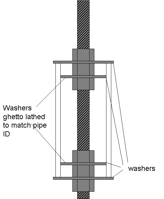

I'm using my own cartridges. I drew my inspiration from Boltsniper's FAR, and my replacement bolt face will very likely be a carbon copy of his, though re-sized a bit. The one I made has just two staples for an extractor (only works for like freaking ten shots before it has to be tweaked manually) and doesn't cover the rear of the cartridge like it should, not to mention that right over that area in the receiver there is a bit of a mistake in the cut, so there is a gaping hole over the rear of the cartridge, meaning that maybe half of the air is blowing out the top. The new design for a bolt face should completely eliminate this. Even though the FAR's shells are easier to make, they are hella big, so I went the much more difficult route and just used straight-up 1/2" Sch40 pipe lengths with a rimless design. By rimless, I mean the modern rim design, not a completely smooth cartridge. If anyone has pointers in securing a piece of 1/2" pipe in a lathe made from a drill, I would be eternally thankful.
(Only one out of the seven cartridges I made will even chamber properly.)

try using washers setup like below, I forgot to add lock washers, but anyways that should help, if the pipe slips then a single drop of super glue should hold it and still be removable laterIf anyone has pointers in securing a piece of 1/2" pipe in a lathe made from a drill, I would be eternally thankful. Sad (Only one out of the seven cartridges I made will even chamber properly.)
I've considered using my miter saw for grooves in rimless pvc cartridges, if you have one you should try it, because the thick blade tends to cut perfect grooves about 2-3mm wide, a different kind of circular saw might work but be careful
- ghetto lathing pvc.PNG (21.48 KiB) Viewed 4901 times

Hmm, looks like it should work. I'll try it next chance I get. I had a jig that I made out of mighty putty and scrap PVC where I would put a cartridge to receive its rim in a half of 1" pipe, then my dremel would fir down onto one end where I would clamp it down, then I would adjust the bit to get the proper groove placement.
I'd try the miter saw, but I like having fingers.
Not to mention it seems like it would be difficult to get locked in place. I would use the miter saw to cut them to length though. (Bye bye crooked PVC cutter cuts!)
