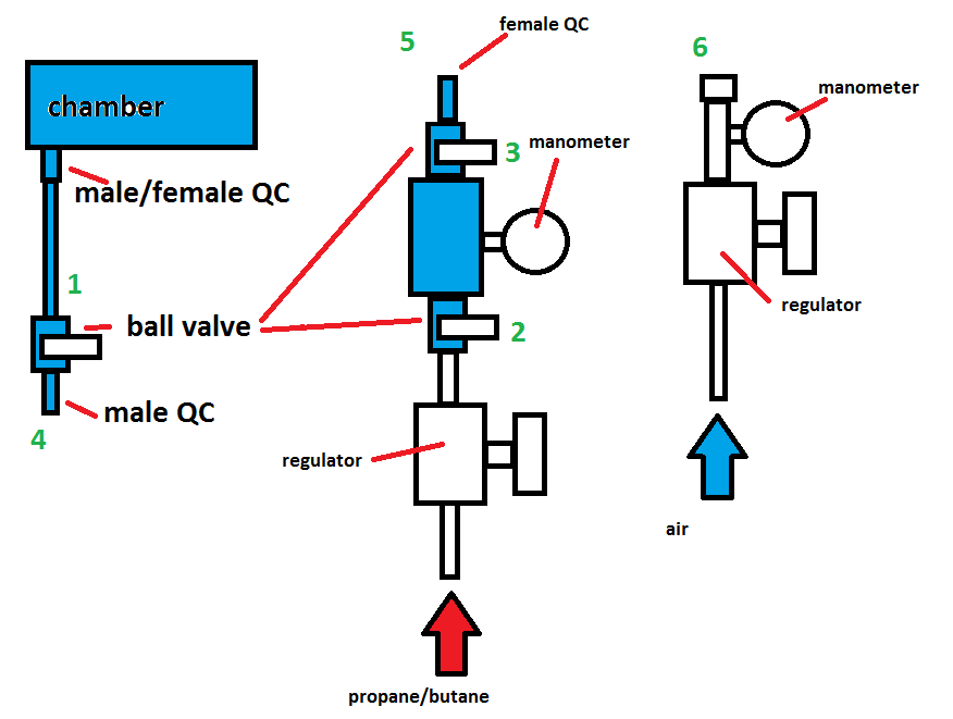

This is how I suggested fuelling, see also attached diagram:
let's say you want to fill it to 10x.
let's say the chamber is 200cc (up to valve 1) and the total area in blue (including chamber, pipes, connections up to valve 2) is 250cc
a) connect the air supply (6 to 4)
b) open valve 1 and fill with air.
to calculate the correct pressure, you need a final pressure of 9 bar in the chamber (pressure = mix number - 1, in our case it is 10 - 1 = 9)
this means that pressure to fill the chamber is (total volume / chamber volume x final pressure )
in our case, this is ( 250 / 200 x 9 ) = 11.25 bar
c) close valve 1 and remove the air supply.
d) open valves 2 and 3 and purge the meter for a few seconds, then close valve 3.
e) connect the fuel supply ( 5 to 4 )
f) open valve 3
g) fill with fuel (valve 3 open, valve 2 open, valve 1 closed) to the correct pressure, calculated as follows:
First, we find the volume of fuel we need at 1 bar, this is (3.5 / 100 x mix number x total volume)
in our case, this is (3.5 / 100 x 10 x 250) = 87.5cc
The pressure we need to fill to is (volume needed / meter system volume x 1 bar)
in our case, this is (87.5 / 50 x 1 ) = 1.75 bar
be careful that this is *absolute* pressure; most manometers are reading 1 bar when the needle actually marks 0, so in this case you would fill to 0.75 bar.
h) close valve 2
i) open valve 1 and allow the pressure to equalise
j) close valve 1
k) disconnect the fuel system
l) you're ready to fire
