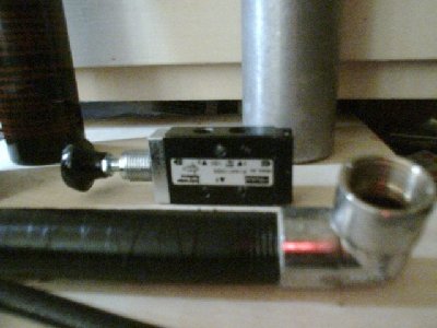

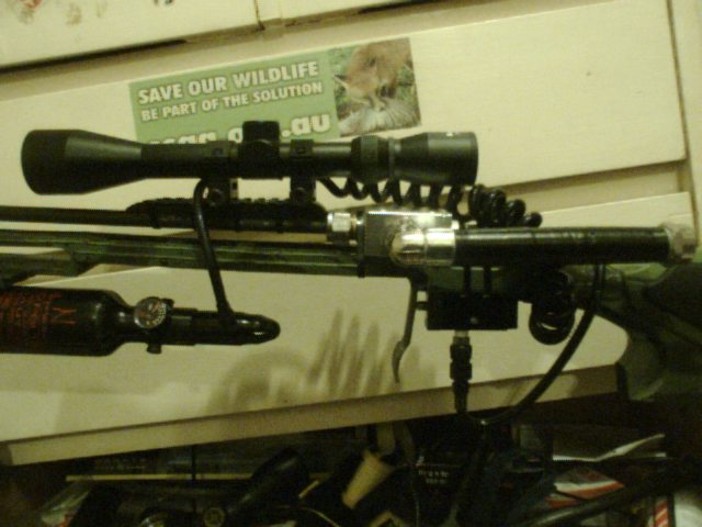

Hey jake, i have recently been shopping around for the same 3 way valves.
I got lucky on ebay with 2 of the parker type valves, its 150psi rated and they cost
$30 each.... (in photo), you see the "button type" and the "lever type" parker 3 way
valves. However, i would not recomend the button type unless you like an extra heavy
trigger pull, which is dissapointing. The lever action type (on the rifle) is much easier, so
thats what i'd suggest to buy from my experience. I nearly bought the one on ebay you are
talking about for $10, but i found a slightly better one on ebay for $15 from a seller called
"fitprice". The product is called a "pneumatic 2 position 3 way spring return button air valve".
They also sell cheap QEV's etc.

Hi waza8u, how heavy is the trigger pull/action on the ebay $10 three way valve?
Hi jonseyjonesy42 wrote:waza8u wrote:yea that one will work fine, i bought the same one from ebayjake321 wrote:http://www.ebay.com.au/itm/G1-4-Air-Inl ... 2c67e4a141 is this the right one?
but if your going to make the same rifle it will cost you just under US$100
the trigger weight is slightly heavy might take time to wear in so it wont be so heavy
