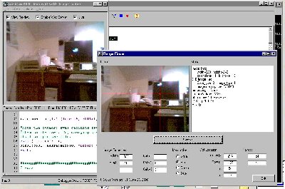

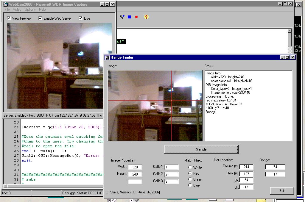

Any old web cam (or any digital camera for that matter) is actually pretty sensitive to IR, certainly more sensitive than your eyes. Most digital cameras will show the blinking of the IR LED on a TV remote control. If you want to boost IR sensitivty you can often take apart the camera and remove the IR filter. I've done it with a cheapo web cam.
Below is a shot of my desktop with an app running that I wrote a few years back. The crappy image in the upper left is from my $20 web cam and the window is the web served version of the cameras output. The bottom right is a perl app that is getting the image from the server, finding the red dot (from a small laser pointer) that is on the computer screen and highlighting that red dot with the red cross hairs. The app has various info like where the dot is in the image etc. (The computer shown is not the one I use, it's across the room from mine. The image was taken at night and the dim room light + crappy web cam = really crappy image.)
Not quite auto-targeting software but miles ahead of anything I would have come up with, nice
