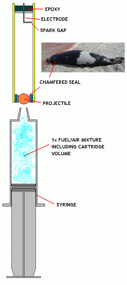

Had a bit of a rethink here about addressing the mixture problem that is likely the failure of my efforts in this endeavor so far.
By having a 1x mix in a syringe and using that to pressurise a cartridge, any pressure you reach would technically be at the right ratio. Using it manually would naturally limit you to the pressures you can achieve through the pressure you can exert, so a possible solution to this would be modifying the syringe to enable the plunger to be pushed by air pressure - that or closing it in a vice ;)
Thoughts?

Hm. Interesting idea JSR. Despite my limited knowledge I think it should work.

It seems like it could be a good idea, the only issue i see is getting a good seal between syringe and your homemade fill valve, perhaps stick with a shcrader with spring removed and just epoxy a good valve cap onto your syringe.
The other thing would be to do the initial fill without a projectile in so the unmixed air can simply flow on the barrel, if you dont do this you are adding to atmospheric air already in the chamber which could mess with your mix, especially in such small volumes.

Looks good, you have a good ability to make things much simpler then I thought was possible! A syringe is genious!
As to the "problem" with the additional atmosphere of air already in the chamber, just add one additional mix of propane to your premix chamber. It worked to fuel a 3/8" tee fitting.

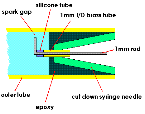

jor2daje wrote:the only issue I see is getting a good seal between syringe and your homemade fill valve, perhaps stick with a schrader with spring removed and just epoxy a good valve cap onto your syringe.
It's actually in my interest to eliminate the schrader, it will help with the arcing problems I was having for small diameter cartridges. As to getting a good seal, the push-fit between the syringe nozzle and the cut down needle will be very good.
Ever tried that old trick of sticking a syringe needle (we're talking the ones with a removable needle like these) in soap or wax in order to block it, then pushing the plunger until the needle segment pops off? Many times, the needle won't come off even if you take the plunger to the end because it's such a tight fit. So not worried there ;)
As SpudFarm pointed out, this can easily be compensated for by adding the cartridge volume to the syringe volume when calculating the amount of fuel to be added.

jackssmirkingrevenge wrote:If this works, the hybrid pengun might actually be feasible ;)
Ah, yes, but how about 300x? :wink:

When looking at your design I might see a problem.
If the seal between the projectile and the chamber is a rubber tube attached in that fachion it might just invert and completely chocke flow.
I would clamp a small steel ring around the rubber tube to make it tighter in one spot. Calculate the surface area of the bb and find out how much weight will act on it when the mix is ignited.
Then you use a ramrod and a scale to push a bb through frequently while clamping the ring a tiny bit tighter after each time.
When the scale tells you that you are at about 60% the weight that will act upon the bb at peak combustion pressure you just cast it into the epoxy.

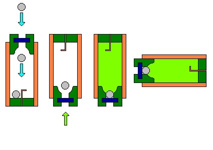

The diagram isn't quite accurate, it would be more like the attached. In that configuration, it should happily hold the BB to 200 psi or so ;)
it looks pretty good...
But you can probably simplify it a bit by turning o-ring detent and the fuelling port into one
POLAND_SPUD wrote:But you can probably simplify it a bit by turning o-ring detent and the fuelling port into one
You might have a point there, the only problem I can see is actually generating enough pressure to relaibly jam the BB in place once you pull the syringe out, though chamfering the seal might help.
yeah that's exactly what I meant... though I'd use a rubber washer not an o-ring...
I think this will help to sped up loading and fuelling process
also If I were you I'd try to find some standard fittings that can be used for an o-ring/rubber washer detent holder.... something as simple as a 1/4" (or 3/8") coupler with a lip + nipple.... or threaded copper pipes adapters
It will certainly make cartridges easier to make.
Why bother with o-rings, washers and standard fittings? I have 6mm O/D 4mm I/D silicone tubing that is perfect for holding 4.4mm BBs up to 150 psi or so and will fit nicely in 6mm I/D brass tubing I will use for the cartridge body, bit of epoxy and Robert's your mother's brother. If the seal wears out, just drill it out and replace it, if not throw the whole thing away and make a new one. I reckon I could make a batch of 25 of these in less time than it takes for epoxy to cure.

By the way, worth pointing out (for the second time in this thread) that this is turning into almost exactly what SPG had suggested back in April 2006 on Spudtech, this is the diagram he had made:

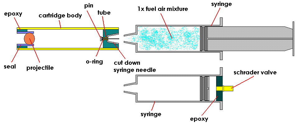

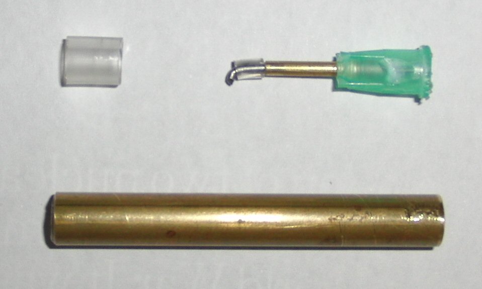

Anyways, prototyping time :)
edit: I made 2 cartridges, one with a separate fill valve and one that is filled through the breech. These are the internals of the former one, I'm not sure if it will seal with this system so I may have to try with a pin/nail and small o-rings of the sort one would find in lighter mechanisms:
